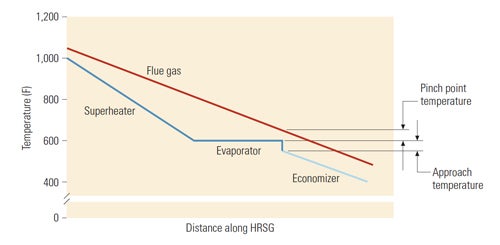

HRSGs are unique in that the temperature differentials between the flue gas and water—particularly toward the evaporator gas exit—are quite low. To maximize thermal efficiency, water temperatures at the end of the economizer circuit run very close to the saturation temperature. The difference between the evaporator saturation temperature and the economizer outlet temperature is called the approach temperature (Figure 1).
1. Pinch and approach points. The temperature differentials between the flue gas and water are quite low. To maximize heat transfer, water temperatures at the end of the economizer run should be very close to the saturation temperature. The schematic shows pinch and approach points for the HP superheater, evaporator, and economizer tube banks. Source: Deltak LLC
If the approach temperature is low—less than 10F—there is potential for economizer steaming. Since most HRSG economizers are either panels or serpentine style, steaming can create major problems. It may cause water hammer and vapor lock in some economizer circuits, causing high local velocities in some tubes and performance degradation of the entire economizer section. If the approach temperature is high—more than 10F above its “as-designed” value—the diagnosis may be economizer underperformance, one of today’s burning HRSG operational issues.

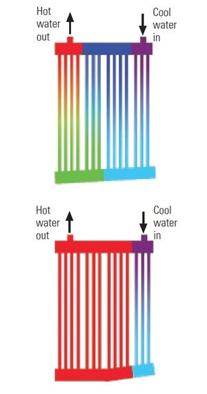

Of the various cycling-related problems bedeviling economizers, pass-to-pass stress—which results when a hot economizer gets “quenched” by a slug of cold water—is the most common, best understood, and most readily corrected (see the sidebar “Preventing and Managing Cold Surges”). This type of stress can be damaging even at differential temperatures as low as 150F. Tube wall thickness is not a major factor, but tube bank geometry is, because poor geometry can produce inadequate flexibility and points of stress concentration.
During the early stages of an HRSG startup, there is no steam being produced in the HP evaporator and hence no demand for makeup water. With no demand for water, the feedwater control valve supplying the economizer is closed; hence, there is no water flow in the economizer. Under these conditions, the temperature of the gas entering economizer sections immediately downstream of the boiler/evaporator sections will be higher than the evaporator’s saturation temperature.
During a startup, if there is no water flow in the economizer before the HRSG begins to produce steam, temperatures within the economizer will approach the flue gas temperature. For an HP boiler, the temperature of the economizer panels can be in the range of 500F to 600F. In a multi-pressure boiler, where the HP economizer may be located behind an LP-boiler section, the temperature of panels may only get as high as 250F to 300F.

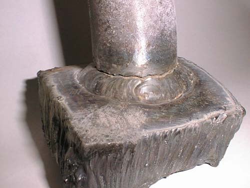

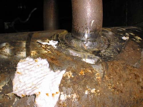

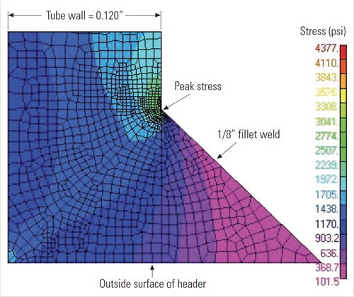

The economizers of all types of HRSGs are vulnerable to the stresses of economizer quenching. The maximum stresses occur in different places (see the sidebar “Fatigue Damage to HRSG Tube-to-Header Joints”), depending on the style of HRSG construction and the means used to restrain the part’s thermal growth, some of which are illustrated in Figures 2 through 5. The transient events that cause the thermal growth that creates the stresses may be short-lived, but they nonetheless shorten the economizer’s available fatigue life each time they occur.
2. Single-row, panel-style construction. This schematic shows shrinkage of the first two passes as the cold surge reaches the end of the second pass. This motion puts stress on the incoming line and the panel-to-panel jumper pipes. Source: Deltak LLC

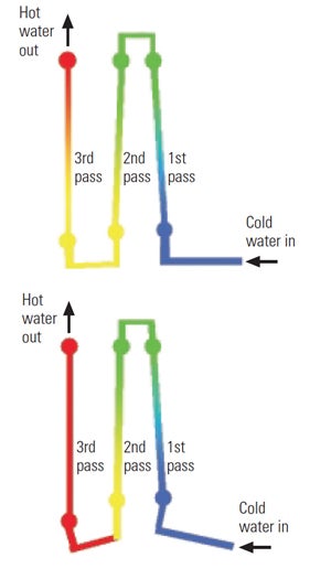

3. Multi-lateral pass style of construction. Shrinkage of the first pass as the cold surge reaches the end of the pass creates loads in the tubes in the first and second pass.

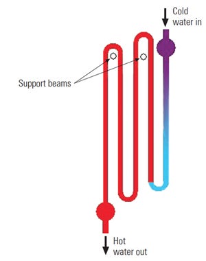

4. Return-bend style. This style of economizer is supported by hanger beams under the upper return bends. When the first-pass tubes shrink, they try to lift the remaining passes off their hanger beam, inducing stresses. Source: Deltak LLC

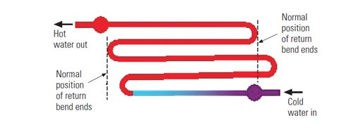

5.Vertical flow. A vertical gas flow HRSG with a horizontal water flow serpentine circuit will experience shrinkage of its first-pass tube when the cold surge reaches the end. When the first-pass tube shrinks, it will try to pull the entire array toward itself. Source: Deltak LLC

Once an HRSG in startup begins to generate steam in its HP drum, demand for cool makeup water will be created and the economizer feedwater valve will open. But because feedwater temperatures for typical HRSG HP economizers are in the range of 250F to 300F, the incoming front of cool water could be several hundred degrees colder than the warm economizer tubes. Regardless of the economizer’s style of construction, when this cold surge of water contacts the hot tubes, it will cause high thermal stresses. The good news is that these stresses don’t last for long because economizers are designed to reach steady-state conditions quickly.
