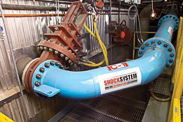

    Pratt & Whitney has long been an industry leader in the development of pulse detonation propulsion technology for applications including commercial and military aircraft, missiles, and rockets. Leveraging this expertise, Pratt & Whitney has developed an on-line detonation cleaning product, aptly called the ShockSystem (Figure 6).
    6. It’s a blast. Typical installation of the ShockSystem. Courtesy: Pratt & Whitney
    Pulse detonation creates a controlled gaseous explosion in a combustor outside the boiler. The blast wave produced propagates in all directions inside the boiler, even around obstructions, reaching areas that are not in the external combustor’s line of sight. Because the detonation is a separate combustion process, it does not require boiler steam or high-pressure plant air. Because the blast wave, which accelerates entrained ash particles to a relatively low velocity, has a short duration, it is expected to produce less wear on boiler tubes than conventional sootblowing technology.

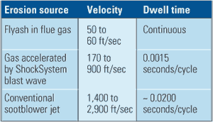

    Industry data suggest that about one in every seven tube leaks in coal-fired utility boilers may be attributable to sootblower erosion. A large body of research specific to coal-fired boilers indicates that impacting particles such as flyash remove protective oxide layers as well as metal from tube surfaces. This not only directly erodes tube metal but also leaves it vulnerable to corrosion from flue gas. The research suggests that particle velocity is a primary factor in the process: The higher the velocity, the greater the erosion and potential for corrosion.
    Boiler tube erosion and corrosion are synergistic. The rate of metal removal reaches a maximum when both mechanisms occur simultaneously. As a result of repetitive impacts by flyash entrained in flue gas or a sootblower jet, a boiler tube’s protective oxide layer can be reduced in thickness or removed entirely, depending upon the severity of the erosion. The reduction or elimination of protection increases the diffusion rate of corrosive elements through the oxide layer, resulting in a time-average corrosion rate that is much higher than that for normal flue gas.
    Even accounting for differences in coal properties and boiler settings, the rate of tube erosion has been found to correlate with the cube of the impact velocity of flyash. In other words, doubling the particle velocity increases the erosion rate eightfold. Designers of pulverized coal–fired boilers usually limit the normal flue gas velocity in the boiler’s convective pass to 50 to 60 ft/sec to limit the tube metal removal rate associated with flyash erosion within 3 to 4 millionths of an inch per hour.
    Particle velocities and dwell times for three potential sources of boiler tube erosion. Source: Pratt & Whitney

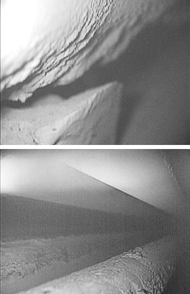

    Initial uses of the ShockSystem on the lower backpass of utility boilers confirm that the blast wave removes platenization (back-spacing) and gas lane pluggage while not removing or eroding away the more tenacious ash sublayer from boiler tube surfaces (Figure 7). If the ash sublayer is not removed, neither is the underlying protective oxide layer. Accordingly, it is anticipated that the blast wave will make only a negligible contribution to tube wear.
    7. Squeaky clean. Economizer platenization at the third and fourth tube rows of a boiler powering a 1,000-MW class unit before (top) and after (bottom) deposit removal by a ShockSystem. Courtesy: Pratt & Whitney
    Long-term ShockSystem erosion data from the field are still being generated. However, an equivalent pulse detonation-based technology has been in continuous use on two 110-MW utility boilers in Bosnia and Herzegovina since the early 1980s. The O&M records at that site substantiate the effectiveness of using blast waves to clean boiler tubes of deposits: The number of tube bursts was 30% lower than conventional sootblowing had produced.

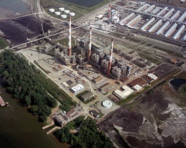

    The Warrick Power Plant in Newburgh, Ind. (Figure 8) is a four-unit, 742-MW, coal-fired, steam-electric facility. Alcoa owns Units 1 through 3, which are rated at 144 MW each, and one-half of Unit 4, rated at 300 MW (Vectren Corp., an Indiana gas and electric utility based in Evansville, owns the other half). All four units entered service between 1960 and 1970. Nearly all of the generation that Alcoa owns is used by the company’s Warrick Operations, an integrated smelting and fabricating facility that produces aluminum sheet for beverage and food can ends and tabs, as well as other flat-rolled products.
    8. Bird’s-eye view. The Warrick Power Plant in Newburgh, Ind. Courtesy: Mikron Infrared Inc.
