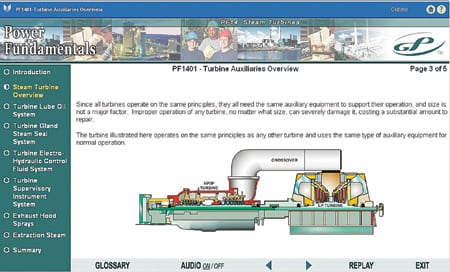

The three core modules of GP’s Power Plant Operators training curriculum are:
  • Power Fundamentals (Figure 2), which gives all kinds of plant workers the theoretical and practical foundation they need. Among its topics are boilers, turbines, combustion basics, ash removal, electrical systems, water treatment, emissions control, and safety.

2.	Training on demand. General Physics’ web-based training curriculum begins with the fundamentals and progresses to advanced, specific topics, such as steam turbine auxiliaries. Courtesy: Minnesota Power
