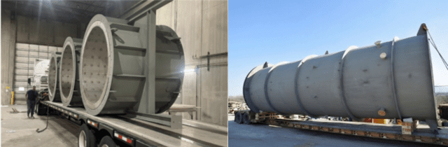

EnergyLink International has recently received orders for 56 selective catalytic reduction (SCR) units and stacks, with many more immediately pending. These SCRs are needed to remove NOx (NO and NO2, collectively nitrogen oxides), CO (carbon monoxide) and VOCs (volatile organic compounds) from exhaust gas streams of turbines that are powering data centers. All orders were for EnergyLink’s Direct Injection SCR—a new technology that cleans the hot exhaust gases more efficiently and at less cost than conventional SCRs, while simultaneously lowering noise (Figure 1). Orders were also for SCRs to limit emissions from a range of turbines: LM2500, T130, and T350.
1. Direct injection ducts being packaged for shipping are shown on the left, while the stack breech for a direct injection SCR unit is shown on the right waiting to be loaded for shipment. Courtesy: EnergyLink

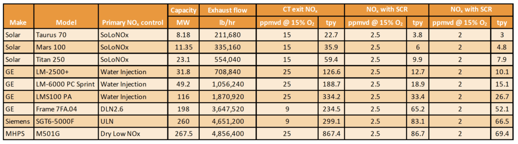

Gas turbine exhaust emissions must meet increasingly narrower limits since the introduction of the Clean Air Act (CAA) in 1970. Today, best available control technology (BACT) limits are 2.0 ppmvd (parts per million by volume, dry) for NOx, ammonia slip, and VOCs, and 6.0 ppmvd for CO. Not all counties must meet BACT standards if air quality is cleaner than the National Ambient Air Quality Standards (NAAQS). In Texas, for example, exhaust emissions adhere to limits of 2.5 ppmvd for NOx and 5.0 ppmvd for ammonia slip (see sidebar). While gas turbine manufacturers use NOx reduction technologies, such as water injection and dry low NOx, turbines burning natural gas are still unable to achieve less than 9 ppmvd to 25 ppmvd, depending on the turbine model (Table 1). The level of NOx increases when diesel or oil fuel is burned.
Table 1. NOx emissions from select gas turbines using natural gas fuel are shown in this table. Source: Dan Ott, president of Environex Inc. (Summary from specifications and field measurement data)

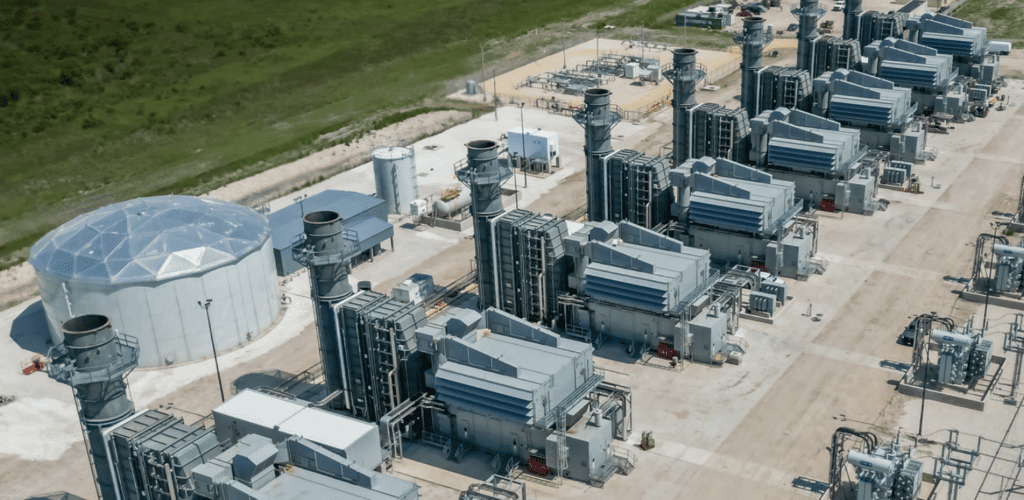

EnergyLink International specializes in “hot” SCR systems, which are SCRs integrated with gas turbines used in simple cycle units. All 56 of EnergyLink’s Direct Injection orders will be baseloaded simple cycle combustion turbines running 24/7 to meet data center electricity consumption requirements (Figure 2). These systems, designed for maximum efficiency, face unique challenges due to the exhaust streams’ extremely high temperatures, and aggressive turbulence and velocities.
2. EnergyLink’s standard (non-direct injection) SCRs and stacks are shown here operating on LM6000PC gas turbines in Texas. Courtesy: EnergyLink
The optimal temperature for catalyst bed performance is between 700F and 800F. Recent catalyst formulations can extend the temperature up to 900F or more. For smaller turbines, such as aeroderivative turbines, exhaust gas reaches 800F and 900F. Exhaust temperatures for larger frame turbines can range from 1,000F to 1,247F. When the exhaust gas temperature exceeds 900F, the gas stream must be cooled with tempering air fans to achieve a temperature conducive to catalyst performance.

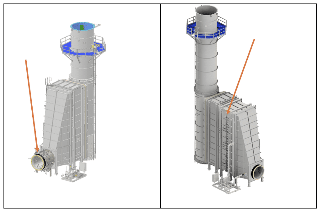

EnergyLink’s Innovative Direct Injection System
EnergyLink International’s new SCR system introduces ammonia in liquid form to the hot exhaust gas stream in a duct right behind the gas turbine—termed Direct Injection (DI) duct or Direct Ammonia Injection (DAI) duct (Figure 3). This technology was tested by EnergyLink using computational fluid dynamics (CFD) modeling, followed by physical flow modeling. EnergyLink’s engineering team posited that both CFD and physical flow modeling would accurately predict emissions levels from a full-scale SCR unit. The objectives for the development of Direct Injection were to deliver a more effective catalyst system that would reduce costs (capital, installation, and operational) and cut plant parasitic loads caused by the SCR and its auxiliary systems.
3. This figure compares the ammonia injection points for Direct Injection (left) versus conventional SCR (right). Courtesy: Energy Link

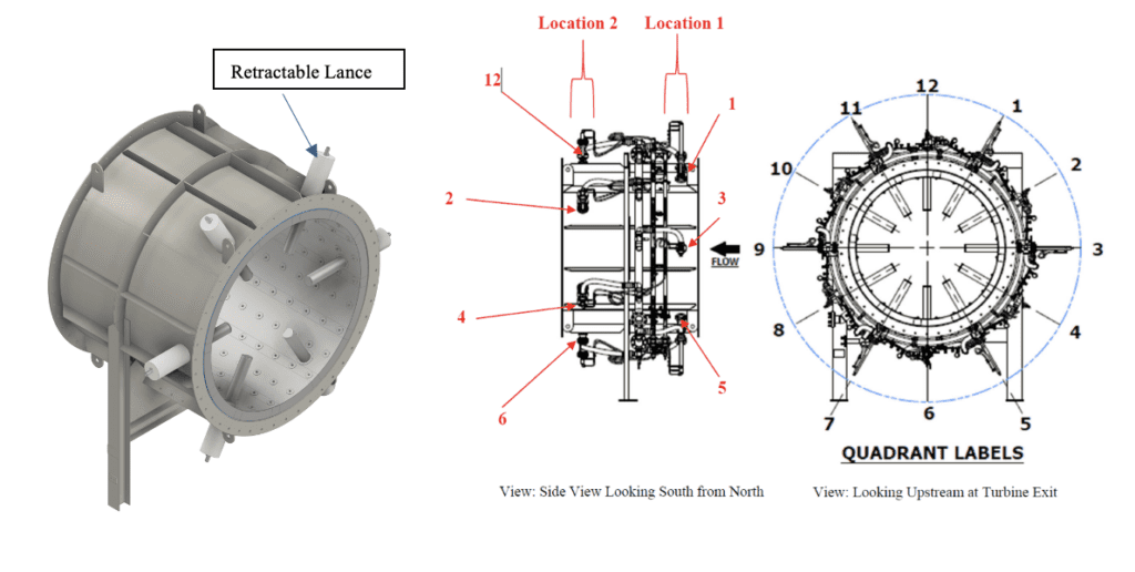

EnergyLink’s Direct Injection method uses multiple, retractable injection lances and nozzles to introduce liquid ammonia into the hot exhaust gas stream in a Direct Injection duct located immediately after the gas turbine exit. The Direct Injection duct is the same diameter as the exhaust diffuser. “That’s about six feet in diameter,” DiMascio said, “so the ammonia injection grid is reduced in area to cover only these six feet instead of the immense area of the Ammonia Injection Grid (AIG) duct,” which is located farther downstream in a conventional SCR. One set of multiple proprietary injection lances with nozzles circle the Direct Injection duct. During testing (Figure 4), EnergyLink performed tuning by adjusting the number of lances and locations to ensure the amount and distribution of ammonia was optimized.
4. The side and upstream views of the experimental lances in the Direct Injection duct are shown here. Courtesy: EnergyLink

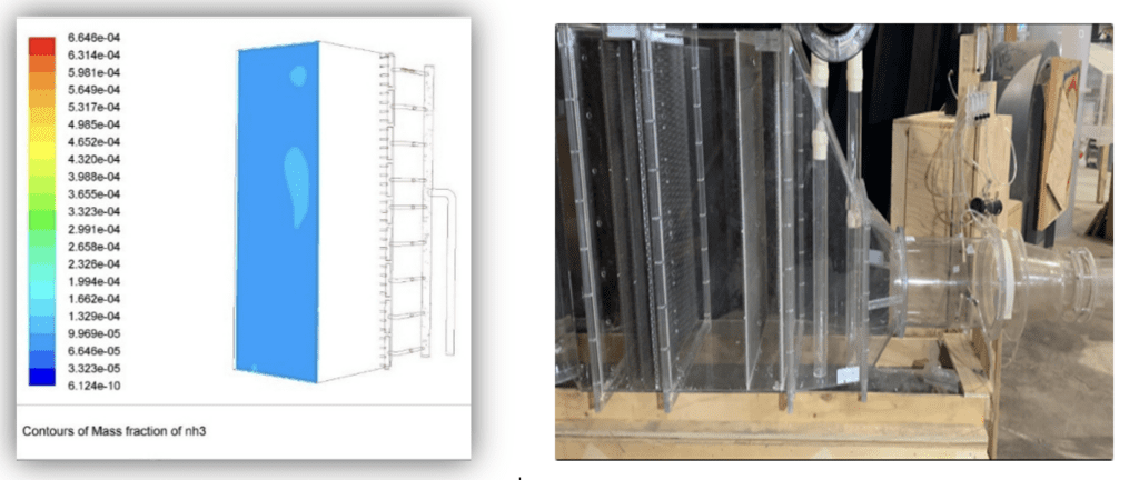

EnergyLink validated its new Direct Injection SCR using four test methods. These were:
  • Multi-point traverse testing downstream of the SCR catalyst for the conventional and Direct Injection SCR systems at differing injection configurations and operating loads.
  • Computational fluid dynamics analysis (Figure 5).
  • Physical flow modeling (Figure 5).
  • Continuous emissions monitoring system (CEMS) data output.
5. An example of the CFD results at the face of the catalyst (left) and the physical flow modeling arrangement (right) are shown here. Courtesy: EnergyLink
A traverse test using the conventional AIG with the gas turbine at baseload (47 MW) established a baseline NOx, CO, O2, ammonia, and temperature profile to compare to the same profile from EnergyLink’s Direct Injection system. EnergyLink’s testing engineers also measured at the stack exit and for partial loads, adjusting ammonia flows and Direct Injection lance positions accordingly to optimize the balance of ammonia-to-NOx.
EnergyLink gathered data from the Conventional AIG System as a baseline, followed by data from the Direct Injection SCR under full load (47 MW), two-thirds load (32 MW), and 50% load (25 MW). Because maximum exhaust flow and the shortest residence time within the catalyst bed occurs during full-load conditions, full load typically governs catalyst bed design. Table 2 shows the test results of physical flow modeling compared to the field traverse tests while the LM6000 gas turbine operated at full load.

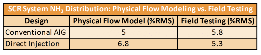

“Direct Injection was predicted by models to be as good as the conventional injection grid in uniformity of mixing (calculated as %Root-Mean-Square),” ProEnergy’s DiMascio noted. “The Braes Bayou plant test showed us it is nearly 10% more uniformly distributed than the conventional injection grid (5.8 %RMS versus 5.3 %RMS) and over 20% better than the models predicted (6.8 %RMS vs. 5.3 %RMS).” Conventional SCR systems, in contrast, register %RMS of 10.0% or higher.
CFD and physical flow modeling of all smaller gas turbine models confirmed that EnergyLink’s Direct Injection SCR system performs as well as or better than the conventional AIG system. DiMascio added, “Direct Injection also gave us 5% lower NOx going out of the stack. This gives us more margin to the current limits, and if demonstrated consistently, it may help us lower the BACT threshold.”
For larger gas turbines, the velocity of the gas turbine exhaust is higher than tested and provides even more turbulent mixing velocities, so lower ammonia-to-NOx ratio %RMS values are expected with correspondingly higher NOx removal levels as modeled. EnergyLink’s testing concluded that its Direct Injection designs apply to all gas turbine models with equivalent ammonia distribution, and therefore NOx removal and ammonia slip, as a conventional AIG system.

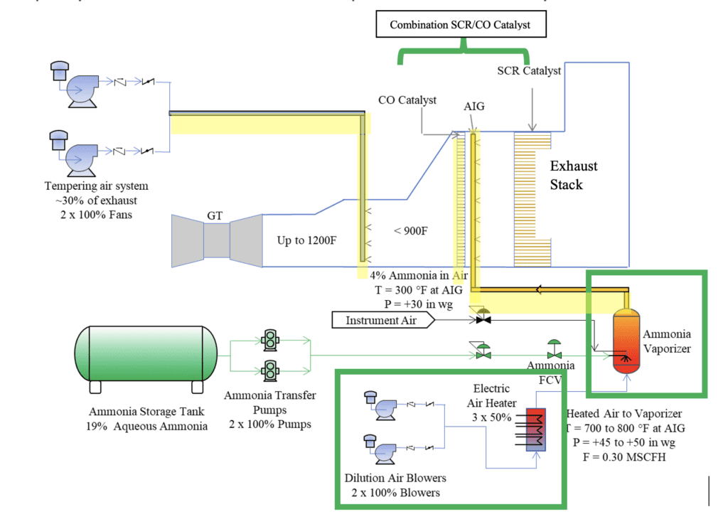

Cost Savings. In EnergyLink’s Direct Injection system, components such as the reducing agent vaporization system heaters, blowers, ducting, injection grid, and associated pipes and valves are unnecessary. ProEnergy’s DiMascio explained, “EnergyLink’s DI system reduces costs primarily by eliminating the vaporization skid and by reducing the size of the ammonia injection grid. [Also reduced is] the stainless-steel piping to cover the catalyst uniformly [and that] is a lot of expensive material and welding.” Reducing these components of the SCR system results in a material reduction of 10% to 20% in capital cost (Figure 6).
6. This process flow diagram shows the equipment modified or eliminated (boxed in green) utilizing the Direct Injection SCR system rather than a conventional aqueous ammonia SCR system in a simple cycle gas turbine. Courtesy: Dan Ott, president of Environex Inc. (Process flow diagram of conventional aqueous ammonia SCR system)

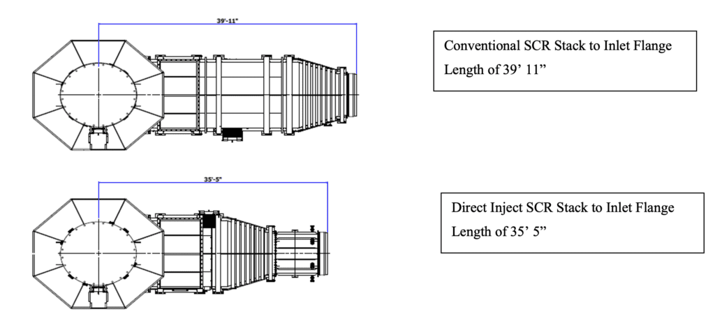

Reduced Footprint. DiMascio continued, “As you know the SCR catalyst is very large in area to slow the exhaust and give NOx time to react with the ammonia. [In a conventional SCR], the ammonia injection grid (AIG) must be the same huge area with very fine spacing of the nozzles to distribute ammonia uniformly over the catalyst. [EnergyLink’s DI system] reduces the overall length of the SCR in front of the catalyst because the ammonia is more uniformly mixed with the exhaust so the whole structure can be shortened—saving on lots of stainless and structural steel [Figure 7].”
7. This graphic compares the footprint of a conventional LM6000 SCR (top) to EnergyLink’s Direct Injection LM6000 SCR (bottom). Courtesy: EnergyLink

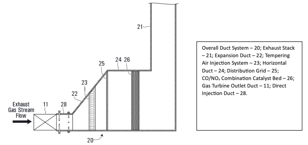

Precise, Adjustable Injection. One of the features of EnergyLink’s Direct Injection system is the ability to inject liquid ammonia at multiple locations and various radial distances in the highly turbulent circular inlet (or Direct Injection duct) to achieve NOx and CO reduction comparable to, or better than, a conventional SCR system. EnergyLink’s Direct Injection system (Figure 8) replaces the ammonia injection grid and its many valves and control devices with a pared-down system of injection lances and custom-designed nozzles that keep the ammonia as a liquid for proper nozzle atomization and are easily adjustable in depth and position to obtain the best % RMS ammonia-to-NOx distribution at the catalyst.
8. EnergyLink’s Direct Injection SCR system. Courtesy: Jeff Wirt and Alan Monshaugen, EnergyLink International (Apparatus and Method for Removal of Nitrogen Oxides from Exhaust Gas, PCT Application No. PCT/CA2023/051608 filed 04.12.2023, published 13.06.2024.)
Reduced Installation and Operating Costs. Lowering the complexity of an SCR by eliminating components significantly lowers installation costs and time. In EnergyLink’s Direct Injection design, the ducting footprint is noticeably contracted with fewer duct sections, smaller foundations, and fewer gaskets, flanges, base plates, and anchor bolts. This smaller catalyst system provides shipping and transportation cost savings as well. Without a large ammonia vaporization fan, parasitic loads and operating costs are also reduced.
