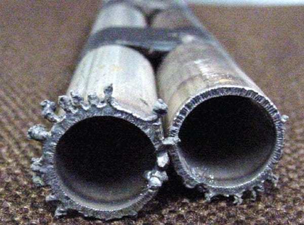

In order to verify the severity of the stress cracking, a tube sample was taken for laboratory analysis that proved the eddy current test was accurate. It would have been extremely difficult, if not impossible, to cut and pull a tube sample from these heaters via conventional methods due to the very heavy tube wall thicknesses. However, American Power Services (APS) was able to extract a tube sample using its advanced plasma arc tube cutter (PATC). APS’s PATC enables the cutting of heavy wall tubes at any length up to the tangent point of the U-bend in order to facilitate tube sample removal. Because the thickness of the tube walls ranged between 0.083 inch and 0.115 inch, cutting and removing (or even accessing) a tube sample would be very tough otherwise (Figure 2).
2. Remove the heater. American Power Services (APS) was able to extract a tube sample using its proprietary and patented advanced plasma arc tube cutter (PATC). APS’s PATC enables heavy wall tubes to be cut at any length up to the tangent point of the U-bend to facilitate tube sample removal. Courtesy: American Power Services

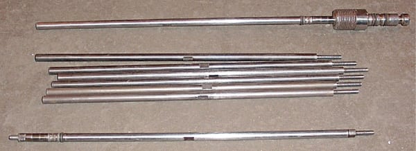

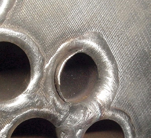

In installing the sleeves, APS employed an advanced hydraulic expansion method that utilized a flexible hydraulic expansion mandrel (Figure 3). The use of a hydraulic expander provides more uniform expansion and superior contact of the sleeve outside diameter with the ID of the parent tube. Additionally, the sleeves were strength-welded to the parent tubes at the face of the outlet tubesheet.
3. Sleeve the heater tubes. Instead of plugging the tubes, APS went in with sleeves that were roughly 7 feet long and installed in the tube inside diameter. The sleeves extended past the area where the stress cracking or excessive wall loss was located. Courtesy: American Power Services

4. Weld the tube ends. The hydraulic expander provides more uniform expansion and superior contact of the sleeve outside diameter with the inside diameter of the parent tube. Additionally, the sleeves were welded to the parent tubes at the face of the outlet tubesheet for added strength. Courtesy: American Power Services
