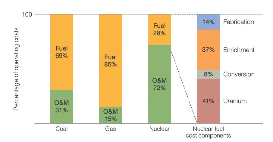

Generally, “nuclear fuel costs have fallen over time due to lower uranium and enrichment prices together with new fuel designs allowing higher burn-ups, while O&M costs tend to be somewhat higher than for other thermal modes of generation,” notes the World Nuclear Association (WNA) in a report published in April this year (Figure 1). A major component of this has involved a dramatic shortening in the length of refueling outages. While in 1990, these averaged 107 days, the average duration dropped to 40 days in 2000. In 2023, in the U.S., nuclear plant refueling outages averaged 35 days, but plants have reported outages of as short as 16 days.
Trillium Ratio of fuel costs Image
Figure 1: Ratio of fuel costs to operating and maintenance (O&M) costs for nuclear, coal, and gas generation. Courtesy: World Nuclear Association, Nuclear Power Economics and Structuring (2024 Edition)

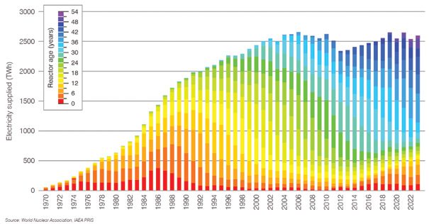

The most urgent initiative facing the world’s nuclear industry, for now, is to sustain stellar operations (Figure 2) at its 415 nuclear reactors across 31 countries. As the International Atomic Energy Agency (IAEA) noted in its September 2024– released Nuclear Technology Review, 295 reactors, or about 67% of global operational reactor capacity (261.8 GWe), have been in operation for more than 30 years, and 142 of those (29%) are over 40 years. “The aging fleet highlights the need for new or updated operating nuclear capacity to offset planned retirements and contribute to sustainability and global energy security and climate change objectives,” the report notes. So far, governments, utilities, and other stakeholders are investing in long-term operation (LTO) and aging management programs for an increasing number of reactors to ensure sustainable operation and a smooth transition to new capacity.
Figure 2. As of December 2023, the world’s nuclear fleet’s capacity was 371.5 GWe, provided by 413 reactors across 31 countries. About 67% of global operational reactor capacity (261.8 GWe, 295 reactors) has been in operation for more than 30 years, while about 29% (112.2 GWe, 142 reactors) has been in operation for over 40 years, and 4% (17.5 GWe, 28 reactors) for over 50 years.  Courtesy: World Nuclear Association

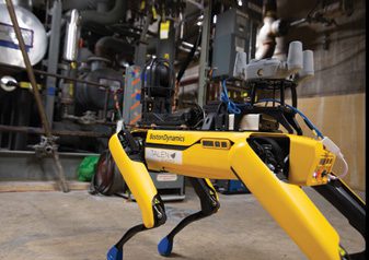

Robots like Boston Dynamics’ “Spot” are actively enhancing operations at facilities such as Talen Energy’s Susquehanna plant in Pennsylvania (Figure 3), Duke Energy’s Oconee Nuclear Station in South Carolina, and Ontario Power Generation’s Pickering Nuclear Generating Station in Canada. At Oconee, Spot assists in inspecting hard-to-reach areas, including underground piping and containment buildings. According to EPRI, future advancements in AI could allow robots to perform more autonomous tasks, such as identifying issues in real time and possibly even executing corrective actions, which could more substantially reduce manual intervention.
Trillium Talen Energy Image
Figure 3. Talen Energy has tested “Spot” in highradiation areas at the Susquehanna nuclear power plant. Spot can conduct visual and thermal inspections safely and effectively, without the need for costly derates or shut downs. Courtesy: Boston Dynamics

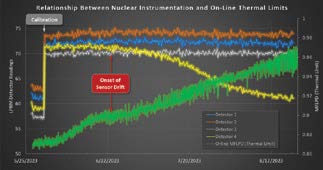

In one particularly illustrative triumph for an AI use case, Indiana-based Blue- Wave AI Labs recently deployed ML tools at Constellation’s Peach Bottom and Limerick boiling water reactor (BWR) plants. Backed with a U.S. Department of Energy $6 million grant, the three-year initiative tested its advanced ML tools at the plants starting in 2022 leveraging vast amounts of historical plant data to analyze and improve sensor measurements within the reactor core. In 2023, BlueWave’s system identified out-of-calibration sensors at Limerick 2, which allowed operators to recalibrate without power output—an intervention that preserved operational efficiency and avoided costly downtime (Figure 4). BlueWave estimates that its AI tools can be deployed across all 32 of the nation’s BWRs within three years, potentially saving the industry up to $80 million by optimizing sensor accuracy, improving fuel management, and reducing manual inspection time. It is also working to adapt the AI algorithms to pressurized water reactors, which make up most of the American nuclear fleet.
Trillium Drifting sensor read
Figure 4. This graph shows a drifting sensor reading (yellow) at Limerick Generating Station in 2023. Constellation used Blue Wave AI Labs’ technology to take the malfunctioning sensor offline, avoiding other remedial actions that would result in lost energy generation. The company intends to expand artificial intelligence (AI) applications to additional reactors in its boiling water reactor fleet. Courtesy: Blue Wave AI Labs
“Constellation’s collaboration with Blue Wave AI Labs has allowed us to use powerful machine learning tools to complement traditional engineering practices when designing innovative nuclear fuel products for our operating fleet,” said Jason Murphy, vice president for nuclear fuels at Constellation. “Widespread adoption of these new tools will benefit nuclear reliability and cost-effectiveness.”

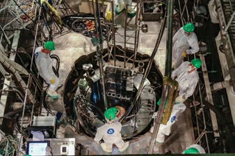

Trillium Akademik Lomonosov
5. Akademik Lomonosov, the world’s first floating nuclear power plant, underwent its first full refueling operation in Pevek, Chukotka, in 2023. The comprehensive procedure involved replacing the entire reactor core for each of its KLT-40S reactors to ensure uninterrupted power. Managed by Rosatom’s specialized teams, the procedure was the most extensive maintenance campaign since the novel plant’s commissioning in 2019. Courtesy: Rosatom
