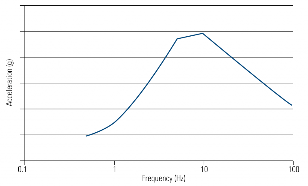

Earthquake vibrations are evaluated on a spectrum of 1 Hertz (Hz) to 100 Hz both horizontally and vertically. The station’s licensing design basis is 0.12g (peak ground force acceleration) at 100Hz.  However, the design accelerations are significantly higher than 0.12g in the critical range of 2Hz-10Hz, where most earthquake damage is likely to occur.
While some of the Aug. 23 earthquake’s vibrations very briefly exceeded the station’s licensing design basis at certain frequencies, none exceeded the level that the station subsequently demonstrated it could withstand, the company said. Station instruments showed that vertical motion and motion along one horizontal direction very briefly exceeded the licensing design accelerations in the 2 Hz to 10 Hz range—by approximately 12% on average in the horizontal direction and by about 21% on average in the vertical direction.
