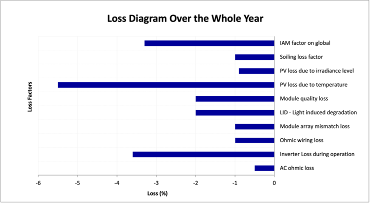

Analysis of Power Generation Losses in Solar Photovoltaic Systems
The amount of power that a solar PV system can generate is primarily determined by three factors: equipment, environment, and construction/ maintenance. In terms of equipment, the performance and lifespan of PV panels, inverters, electrical switches, transformers, and cables are directly related to power generation efficiency and system stability. Environmental factors include changes in temperature and humidity, wind speed, dust accumulation, and shading effects. These conditions can affect the light reception rate and power generation efficiency of PV modules. Additionally, construction quality and subsequent maintenance can critically impact power generation. Wiring conditions and the routine inspection frequency can affect system operations in the long-term.
To quantify how these factors contribute to power generation losses, we used PVsyst simulation software for analysis. Results showed that power generation losses in solar PV systems occur mainly due to four reasons, which are:
  • Changes in sunlight and environmental temperature, which are unavoidable natural factors.
  • PV panel quality and array matching, as mismatched modules may lead to a reduction in overall system efficiency.
  • Inverter operational losses, as inverter efficiency may decline over time, thus affecting the efficiency of direct-current (DC) to alternating-current (AC) conversion.
  • AC and DC wiring impedance losses, that is, energy loss caused by contact impedance in cables and connectors during transmission.
Given that there are relatively mature solutions that address the degradation of PV modules and the decline in inverter operational efficiency, while the effects of sunlight and environmental temperature are external factors harder to control, our study, therefore, chose to focus on reducing wiring impedance losses in AC and DC lines. This was achieved by using super crystalline nanomaterial coating technology, which helps improve power transmission efficiency and reduce power generation losses caused by contact impedance and oxidation. This application helps enhance the long-term stability and energy utilization efficiency of the system (Figure 1).
1. Annual power generation losses of solar photovoltaic systems. Note: IAM = Incidence Angle Modifier. Courtesy: ECOVE Environment Corporation
