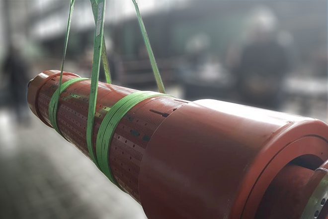

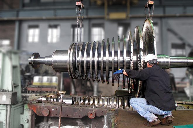

First unit:  This was a major outage and generator test & inspection. In addition, this unit was retrofitted with a new rotor, bearings, and steam path components that required machining, including installing and fitting new nozzles. MD&A provided Project Management, Technical Direction, a Controls Engineer, and a Vibration Engineer for startup and balancing.
In order to maintain the outage’s schedule, MD&A worked closely with the OEM’s engineering team to ensure that the new retrofitted components were installed correctly and to resolve any technical or engineering issues quickly. MD&A’s knowledge, experience and our skilled project manager and technical adviser resulted in this successful outage.
MD&A’s Repairs Division personnel performed onsite final machining of the nozzle plates and their associated shell locations. Our repair technicians also performed on-site diaphragm repairs.
MD&A also provided a packing installation specialist to install and final machine new upgraded packing.
To support the major outage schedule and expedite the on-site work, MD&A sourced equipment locally to overcome the time required to get the specialty tooling and equipment trailers through Colombian customs.
This unit was started up without incident and has been operational since.

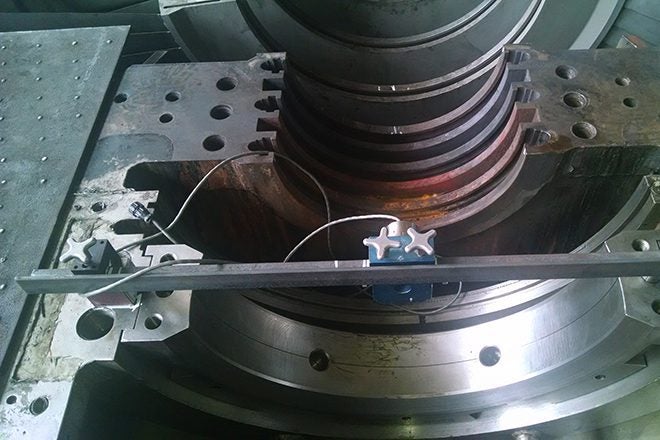

Another unit: MD&A provided Project Management and Technical Direction on a Steam Turbine Generator (STG) major inspection and performed Generator testing and inspection. MD&A also provided a balance engineer, Topless Laser Alignment, and start-up commissioning support through our Control Systems Division (CSD).
The steam turbine had not been inspected for 23 years. Using MD&A’s pre-outage planning processes and experience, the execution team immediately started working to identify & mitigate potential project risks. One example was special tooling, which needed to be located and prepared for use.
After the balancing work was performed, the machine was started up smoothly, synchronized, and brought to full load. This unit has been operational without issue since this start up, after 23 years without maintenance.
