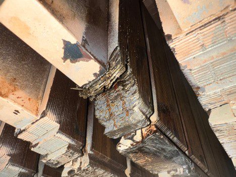

Several 7FH2 units have experienced failures of the core step iron, caused by inadequate compression of the core laminations.  This issue was first brought to light by GE® TIL 2260, which only covered certain units; however, this recent failure was outside the scope of this TIL, indicating that other units may be at risk of a similar failure.

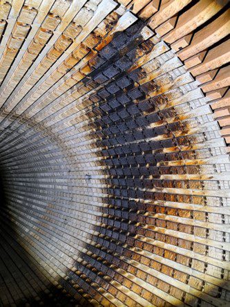

The Robot crawler traversed axially from CE (collector end) to TE (turbine end) utilizing both a straight facing camera and 360-degree rotating camera to assess wedges, core iron condition, field body, and to note any abnormalities. The initial inspection proved highly challenging due to the amount of oil/greasing present on the stator, particularly on TE – as the robot began slipping. At the 12 o’clock position, MD&A noted high amounts of contamination at TE step iron and body wedge system.

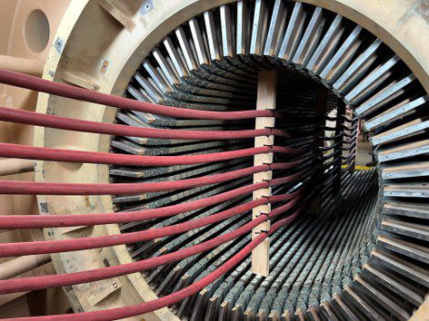

The repair of this unit required that the generator be stripped of all stator windings, followed by a thorough cleaning of the stator to remove all core ferrous debris from the stator prior to performing the rewind.

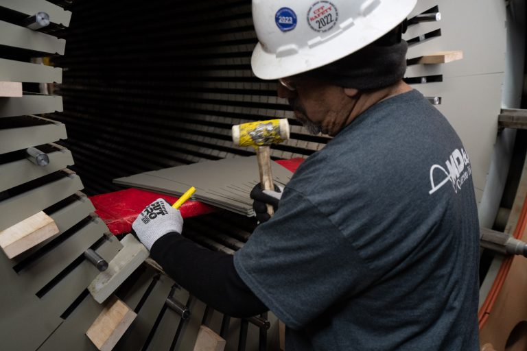

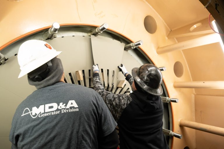

The damaged iron was removed from the stator core in circumferential sections moving axially inboard from the TE step iron where the fretted iron was located. Core iron packs were removed just past the damaged section to ensure reliability for future operation of the unit.
Once the core iron was removed, new core iron was replaced in the reverse process, moving axially outboard in circumferential bands. With the new core iron in place, MD&A then axially compressed the core to the required values. A Core Loop test was performed at the completion of the partial re-stack to verify successful compression of the new core and to ensure no hotspots were present on the newly installed or original remaining core iron.
After the core iron was replaced, new 7FH2 generator stator windings were installed. All quality checks were performed according to MD&A procedures to ensure reliable future operation of the unit.
