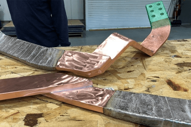

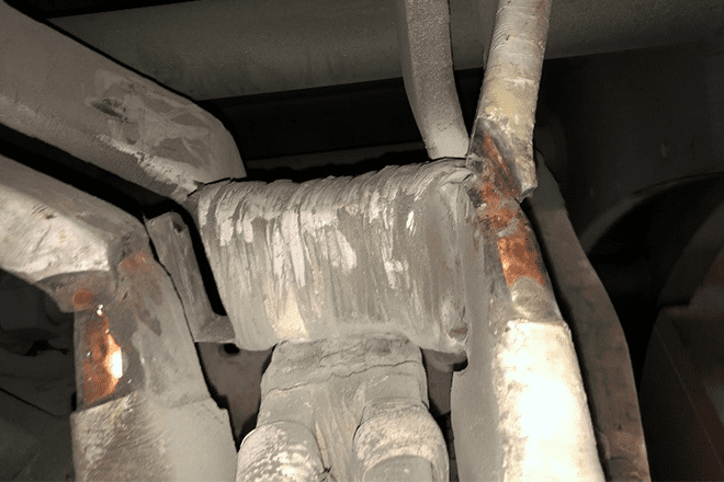

The Generator Specialist immediately recognized that the stator had significant connection ring damage that could have led to catastrophic damage had it continued to operate.
The solution: MD&A expeditiously removed, reverse engineered, and replaced the damaged components with no impact to overall outage schedule (5 days total repair time).
Scoring was identified on both the turbine-end and collector-end journals. The lower half bearings had moderate abrasion/scoring. Minor babbit damage was also noted. The turbine-end and collector-end hydrogen gas and air side seals were found in poor condition and replaced.
Winders were mobilized to perform numerous tie repairs on each end of the unit and connection ring replacement on the collector end with the rotor still in place.
As a result of MD&A’s impact testing and modal analysis, additional blocking and ties were made on the connection rings to ensure the unit will not see this type of problem again.
