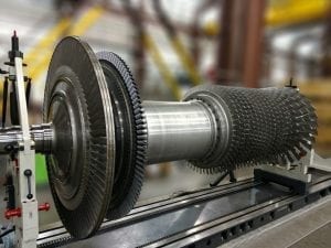

Mechanical Dynamics & Analysis (MD&A) repaired a Frame 5 gas turbine rotor.  MD&A replaced 1st and 2nd stage buckets, repaired the seal area on the row 1 turbine wheel, performed compressor blade blending, and machined the thrust collar to accommodate the newer style thrust bearing at the No. 1 bearing.

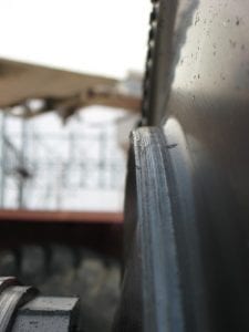

Upon inspection, our gas turbine experts discovered that the Row 1 turbine wheel showed indications of heavy wear caused by rubbing to the rear face of the discourager seal. To repair this, the seal area was prepped and built up using a spray metallizing process.
Once the precise build-up was achieved, the seal area was ground to the correct dimensions and contours. In addition, wear damage to the Row 2 turbine disc sealing area was repaired to achieve an acceptable surface after a fluorescent penetrant inspection was completed.

Progressive balance work was completed on two turbine bucket stages. MD&A experts replaced both stages of buckets.

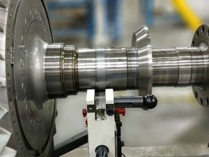

Our experts also performed the modification to the gas turbine rotor which involved machining the thrust runner face that is located at the No. 1 bearing. This is a common recommendation for the Frame 5 fleet to improve the reliability and operation of the thrust bearing.
Skilled technicians from MD&A’s Bearings, Seals, and Hydraulics Division re-toothed the rotor’s oil deflectors and re-babbitted the bearings.
New replacement buckets were provided by MD&A Parts. The rotor was progressively low speed balanced as the 1st and 2nd stage buckets were installed, technicians secured balance weights and completed the six-point residual unbalance test.  The rotor was then packaged & secured on the shipping skid.  Finally, MD&A transported the rotor to site and successfully supervised the re-installation.
