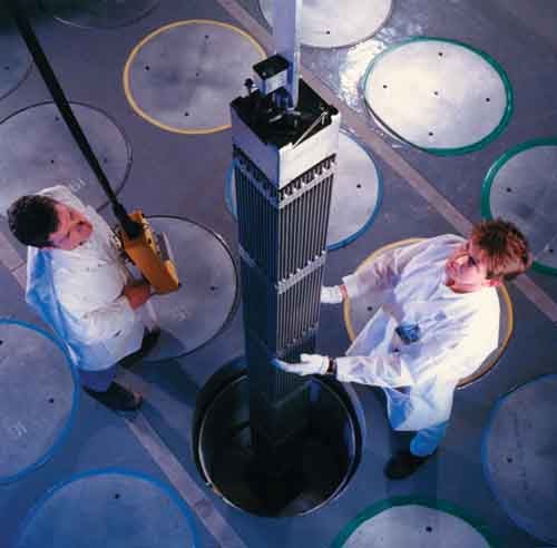

Meanwhile, only two plants globally currently produce commercial MOX fuel quantities: AREVA’s 195-metric tons/year Melox plant and the 40-metric tons/year Sellafield MOX (Figure 2) plant in the UK. Construction of a MOX facility at the Savannah River site in the U.S. is also under way by a Shaw Group/AREVA consortium. Expected to begin operations in 2016, that plant is designed to turn 3.5 metric tons/year of weapons-grade plutonium into MOX fuel assemblies.
2. A MOX box. Workers at the Sellafield MOX plant in the UK load a mixed-oxide (MOX) fuel assembly. According to the World Nuclear Association, MOX is expected to supply about 5% of global reactor fuel requirements by 2010. Japan recently began using MOX fuel for the first time—at the Kyushu Electric Power Co.’s Genkai nuclear power plant. Several nuclear companies in that country are expected to follow suit. Courtesy: Nuclear Decommissioning Authority
