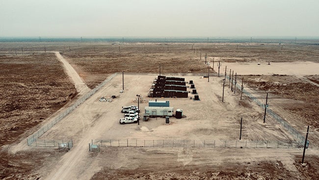

Miss Kitty comprises eight MTU 20V4000L64FNER reciprocating engines, each delivering 2.6 MW of nameplate output. The engines’ configuration optimizes reliability over maximum throughput, consuming approximately 1,500 to 1,600 thousand cubic feet (MCF) per day of natural gas to generate consistent industrial power for Riley’s operations, Maxwell said. The project’s fuel pathway also illustrates sophisticated integration with existing infrastructure. Natural gas from Riley’s wells flows to the nearby Stakeholder 30-30 processing plant, where it undergoes treatment to meet MTU’s stringent composition requirements. These include heating values between 8-11 kWh/m³, methane number stability within±5 MN/min, and heating value deviation of±5%. After processing, the gas returns at approximately 100 PSI through a dedicated pipeline equipped with emergency shutoffs, gas chromatography, knockout drums, and filtration systems. At the generation site, pressure drops to 3 PSI before combustion (Figure 1)
1. The 20-MW Miss Kitty microgrid in Plains, Texas, uses treated natural gas from Riley Exploration Permian’s nearby wells into 24/7 islanded power for the company’s private-use network. Courtesy: Conduit Power
The electrical design evolved in two phases: Gen Site 1, brought online in April 2024, operates at 600 V with 600-V auxiliaries, and Gen Site 2, commissioned in October 2024, operates at 13.8 kV with 480-V auxiliaries. Both tie into Riley’s 24.9 kV private-use network, stepping up power via transformers and enabling seamless integration with field operations. Load sharing across eight units ensures dynamic response to pump and compressor demands, albeit with some frequency and rpm variability as engines adjust to real-time loads.
Conduit Power managed engineering and oversaw Summit Industrial as the engineering, procurement, and construction contractor. Although supply chain constraints delayed the planned 4.5-month site prep-to-commissioning, construction began in April 2023 and concluded in late 2024. Equipment shortages prompted a temporary turbine solution—initially an SMT 60, then a Taurus 60—running alongside two commissioned reciprocating engines. Mixed-generation load sharing, however, proved complex. “Because of their different sizes and different OEMs they were not able to load share together making the power plant control complicated,” Maxwell explained. However, the experience informed future deployment strategies and reinforced the value of standardized equipment selection for operational simplicity.
The project’s modular design also eased maintenance at the remote site. When a generator bearing failed, the entire skid-mounted unit was wheeled to the factory for repair. Maxwell noted that local workforce integration bolstered community impact. Contractors from Hobbs, New Mexico, two Plains-based operators, and an operations manager joined the project team. Permitting followed a swift Texas Commission on Environmental Quality standard pathway—3–4 weeks for air permits and concurrent Title V applications—far faster than ERCOT and SPP’s multi-year interconnection queues.
