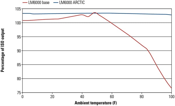

A third option has now proven its worth in long-term operation. The Absorption Refrigeration Cycle Turbine Inlet Conditioning (ARCTIC) system—developed by Energy Concepts Co., with team members Kiewit Power Engineers and Nooter/Eriksen—uses an exhaust heat–powered inlet air-conditioning system (Figure 1). With ARCTIC, the net output of the LM6000 on the same 100F day increases to 51 MW, with no heat rate degradation. The performance gain comes from using exhaust heat to produce the necessary chilling, thus avoiding the roughly 2 MW parasitic penalty of mechanical compression (based on a 2,000-ton centrifugal chiller). Figure 2 illustrates the performance gains achieved with and without using ARCTIC on an LM6000 PC SPRINT.
1. New inlet air-cooling option. An LM6000 PC SPRINT combustion turbine with ARCTIC has completed three summers of operation in central Texas. The ARCTIC system is designed to operate in tandem with the remote start of the LM6000. Courtesy: Energy Concepts Co.
2. Flat-line performance. The ARCTIC-equipped LM6000 PC SPRINT with NOx water injection is shown as a percentage of ISO output across a range of ambient temperatures. The SPRINT version of the LM6000 also uses water injection into the high-pressure and low-pressure compressors to produce an additional 3.5 MW across all ambient temperatures. Source: Kiewit Power Engineers
An LM6000 PC SPRINT with ARCTIC system installed at a central Texas utility has demonstrated this capability nearly every day for the past three summers, operating for 2 to 12 hours per day, in response to market conditions. The system requires no operators and functions fully automatically by matching the CT’s 10-minute start to full-load power sequence. When the CT shuts down, ARCTIC automatically shuts down after a short cool-down period.
There were approximately 400 starts of the LM6000 during a three-year demonstration period of the ARCTIC system. During this demonstration, the ARCTIC automatic start sequence failed only five times, producing a start reliability of nearly 99%. Importantly, failed starts were all nonrecurring failures. In each case of a failed ARCTIC start, the CT start and operation continued without interruption. The LM6000 merely operated without the warm weather performance enhancement.
