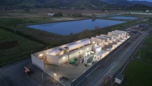

Energy Vault and PG&E on September 25 announced the successful completion and commercial operation of the Calistoga Resiliency Center (CRC), which will serves customers in and around downtown Calistoga, a small town in the northern Napa Valley. The microgrid integrates advanced hydrogen fuel cells with lithium-ion batteries. The companies on Thursday called the facility a “landmark project [that] provides a unique, fully sustainable solution to address power resiliency amidst the growing challenges of wildfire risk in California.”
The CRC will support the need for power in the area, particularly during wildfires and other extreme weather events. The 293-MWh microgrid system is designed to enable Calistoga to maintain power during Public Safety Power Shutoffs (PSPS), a utility protocol deployed to mitigate the risk of wildfires from electrical equipment.
The companies said the microgrid will deliver at least 48 hours of continuous supply with a peak power output of 8.5 MW during PSPS events. “This zero-emission system aligns with California’s Renewable Portfolio Standard (RPS) while meeting PG&E’s multi-day, long-duration energy storage requirements,” according to the companies.
Energy Vault said the system is orchestrated by the company’s technology-agnostic VaultOS Energy Management System, enabling black-start, grid forming and coordinated performance orchestration across all subsystems while communicating with PG&E’s Distribution Control Center.

The CRC when operating in island mode utilizes hydrogen fuel cells for electricity generation. It supports black-start and grid-forming requirements of the microgrid, Energy Vault’s B-VAULT DC battery technology works in concert with the fuel cells, ensuring instantaneous response and maintaining grid stability throughout operation.
The use of liquid hydrogen enables extending run time through delivery and transfer into the onsite storage tank without interrupting power supply to the town, and also reduces the cost of resiliency services. The companies said the CRC “serves as a model for Energy Vault’s future utility-scale hybrid microgrid system deployments as the only existing zero-emission solution to address PSPS events that is scalable, bankable, and ready to be deployed across California and other regions prone to wildfires as well as locations where improved grid-resiliency is needed.”
