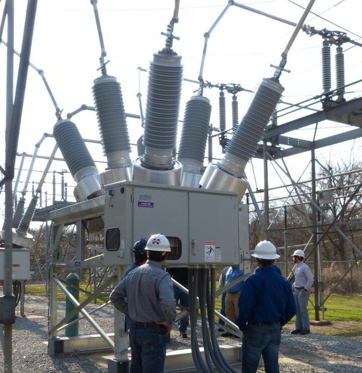

Siemens Energy’s clean air breakers (Figure 2) have a vacuum interrupter and they are sealed for life; therefore, no maintenance is required. Today, circuit breakers rated up to 145 kV, and 40 kA and 63 kA, have been successfully designed and tested. A 245-kV breaker is in development and is expected be available by 2027. Siddiqui said once these are available, the products will cover about 75% of utility and industry breaker requirements. Still, higher voltage classes, including 420-kV and 550-kV designs, are next in line for development.
2. An installed Siemens Energy clean air vacuum circuit breaker is shown here. Courtesy: Siemens Energy
Because of the vacuum design, arc energy is lower in a clean air circuit breaker than in an SF6 breaker, which results in a much longer life. Extensive third-party testing found the clean air vacuum breaker lifetime could be double that of an SF6 breaker. Furthermore, the clean air design can operate in extreme cold temperatures (as low as –60C) without requiring external tank heaters—a very attractive benefit for customers in frigid climates.The solution has been well-received by the industry. “Siemens Energy has over 4,200 circuit breakers and gas-insulated switchgear from the clean air Blue portfolio contracted worldwide. Of these, 1,500 are in operation and to date have saved 4.4 million tons of CO2 emissions,” said Siddiqui.
