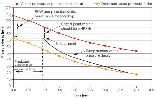

During the passage of the hot-water slug, the combination of high vapor pressure at the pump suction along with a decrease in pump suction pressure (due to DA pressure decay), results in a "critical point" at which the suction pressure may drop below the minimum required pressure (that is, the vapor pressure of the hot-water slug plus the pressure equivalent of the NPSHr). This low suction pressure could result in cavitation damage to the pump internals due to insufficient net positive suction head.
Short Residence Time
The time required for passage of the hot-water slug through the pump suction line is the "residence time." Residence time can be expressed as the suction line volume divided by the volumetric flow rate (or, alternatively, as the mass of liquid in the suction line divided by the mass flow rate).
Note that because the vapor pressure at pump suction is modeled to decay only after the residence time has elapsed, the critical point occurs at the end of the residence time interval. The challenge is to determine the DA pressure at this critical point and thereby the system NPSH margin.

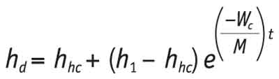

Establishing the Deaerator Pressure Decay Curve
A simplified way to express the DA pressure decay is by the exponential decay equation for enthalpy. In addition, the corresponding DA pressure at any time is the saturation pressure at the calculated DA water enthalpy:
where,
hd = enthalpy of deaerator water storage tank at any time t, Btu/lb
hhc = enthalpy of condensate in condenser hotwell, Btu/lb
h1 = initial enthalpy of deaerator water storage tank, Btu/lb
Wc = condensate flow after steam cut-off, lb/min
M = mass of water in deaerator storage tank, lb
The actual pressure at BFW pump suction is simply the DA vapor pressure as computed by the equation plus the DA static head less the frictional pressure drop in the BFW pump suction piping.
This equation conservatively models the system well but does not consider the warm condensate contained in the low-pressure (LP) heaters and the condensate piping.
If using the equation on your system indicates a problem with the BFW pumps’ capability in handling the DA transient, you may want to recheck the calculations using the more exact equations available in this reference source: Liao, C.S., and Leung, P., "Analysis of Feedwater Pump Suction Pressure Decay," ASME Journal of Engineering for Power (April 1972). However, the approach described in this article uses a more conservative approach to the calculations.
Note that the condensate flow to the deaerator (Wc) after steam cut-off must be established correctly based on subsequent boiler load and spray water consumption in the steam attemperators. The boiler load is also assumed to be limited to the capacity of the turbine bypass system.
Establish Critical Point Margin
Figure 2 shows a plot of the actual measured pressure at the BFW pump suction and the DA vapor pressure for a typical steam power plant. The difference is the available NPSHa at the pump inlet. Also note that during the DA pressure transient, the actual pressure at pump suction decreases as the DA vapor pressure decays for almost a full minute. However, due to the time it takes for this hot-water slug in the pump suction line to pass, the pump suction vapor pressure does not decrease until after the "critical point," corresponding to the BFW pump suction pipe residence time where the NPSHa is at a minimum. If the value of NPSHa at this point (critical point margin) falls below the pump NPSHr, the system design is inadequate and the pump could be damaged due to cavitation of the fluid inside the pump during the transient.
2. Good correlation with theory. The proposed simplified calculations to determine NPSH in the deaerator system give a close, conservative estimate of the more analytic approach described in the reference. Source: Bechtel Power
