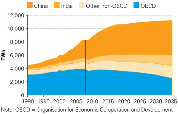

Globally, coal will remain king though 2035, though its use for power generation will diminish from 41% now to 32% (Figure 1). Natural gas use will grow in absolute terms, continuing to fuel 21% of world electricity generation through 2035. Growth in natural gas will far surpass the growth in other fossil fuels’ use, owing to its “more favorable and practical attributes, and constraints on how quickly low-carbon energy technologies can be deployed,” the agency said.
| 1. Coal to remain king. The International Energy Agency (IEA) forecast in its newly released World Energy Outlook that coal will remain dominant worldwide through 2035, though its use for power generation will diminish from 41% now to 32%—putting it on par with the global share of renewable generation in 2035. This graph shows how the drop in coal-fired generation in developed countries (members of the Organisation for Economic Co-operation and Development [OECD]) is expected to be more than offset by massive increases elsewhere—especially in China. Worldwide coal-fired generation is projected to increase from 8,273 TWh in 2008 to about 11,200 TWh by 2035. China could add nearly 600 GW of coal-fired capacity, which exceeds the combined current coal capacity of the U.S., the European Union, and Japan. Courtesy: IEA |
