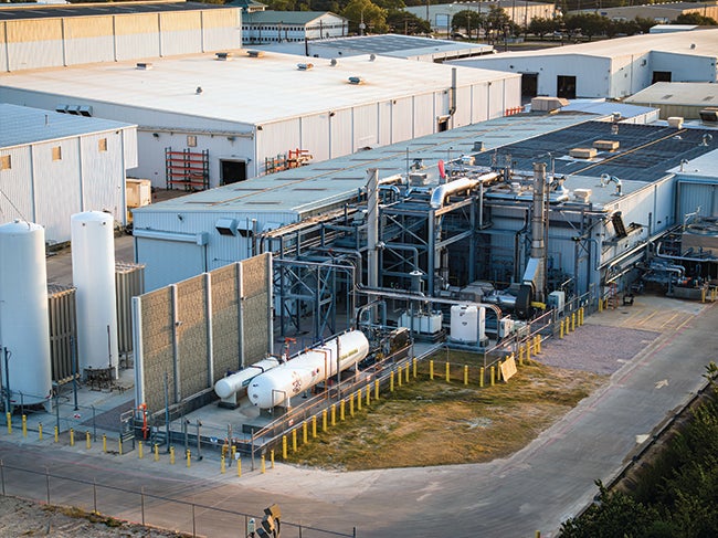

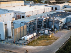

1. Amogy, based in Brooklyn, New York, and with manufacturing facilities (shown here) in Houston, Texas, has developed technology to split ammonia into its base elements of nitrogen and hydrogen, and then use the hydrogen for clean power. Courtesy: Amogy |
Amogy, based in Brooklyn, New York, and with manufacturing facilities (Figure 1) in Houston, Texas, has developed technology to split ammonia into its base elements of nitrogen and hydrogen, and then use the hydrogen for clean power. The company provides carbon-free energy solutions to decarbonize hard-to-abate sectors including power generation, maritime shipping, and heavy industry. The group’s ammonia cracking technology offers a method for splitting ammonia into hydrogen and nitrogen; the produced hydrogen is directed to integrated fuel cells or hydrogen engines, generating high-performance power with zero carbon emissions. The company is involved in several power generation projects in Asia and elsewhere. Amogy technology last year powered the world’s first clean ammonia-powered vessel (Figure 2) on the Hudson River upstream from New York.

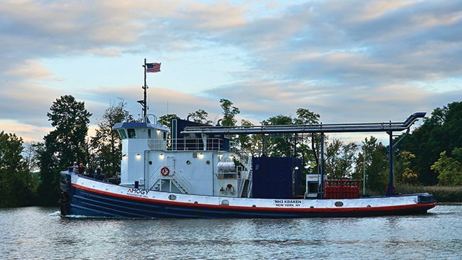

2. Amogy technology last year powered the world’s first clean ammonia-powered vessel on the Hudson River upstream from New York. The NH3 Kraken tugboat, originally built in 1957, was initially powered by diesel generators and electric motors. It has now been retrofitted with Amogy’s innovative ammonia-to-electrical power system, which emits zero carbon. Courtesy: Amogy |
