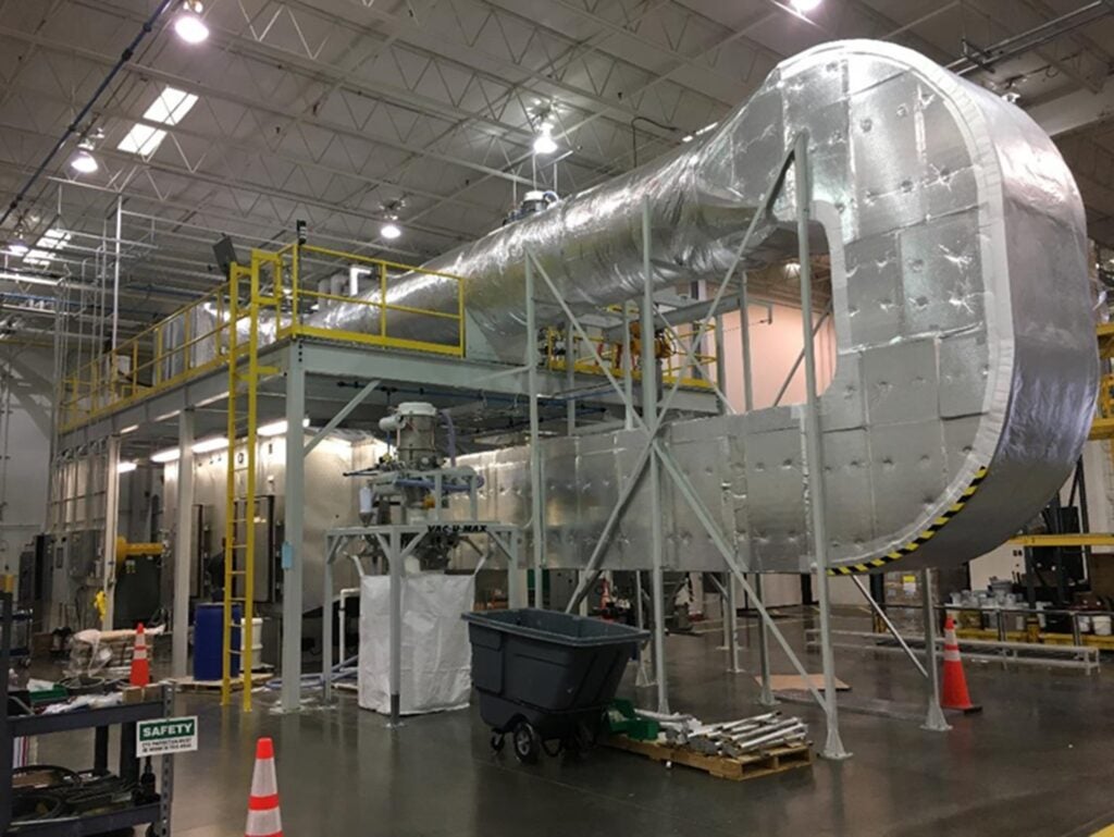

Key developments in self-cleaning filter design have focused on reducing dead space in the filter house by packing filters close together, increasing the available filtration area in a given volume, and improving the flow distribution along the length of the filter compared to the industry standard “cone and cylinder” cartridge filter. In parallel to this, substantial research has been carried out on the filter cleaning system (Figure 1) to ensure that optimal pulse cleaning is still achieved. Particulates accumulating in the filter media are dislodged by the pulsing system, after which they fall to the floor and are collected for disposal. The filters are pulsed in a sequence and the dust is collected in a hopper at the bottom and then removed either with another compressed air system or with a screw auger.
1. State-of-the-art, environmentally controlled wind tunnel for testing pulse filters. Courtesy: Parker Hannifin Ltd.

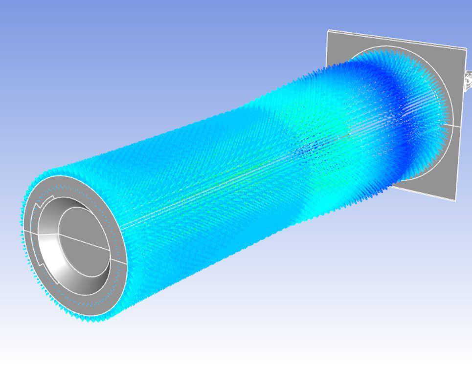

This kind of system requires some space for the particulates and other material to be removed from the filters, which restricts the maximum filter packing density achievable. It requires a delicate balancing act between serviceability and compactness. Much of the R&D effort has, therefore, been focused on sophisticated analysis, not just of the filtration cartridges (Figure 2), but also on the related ancillary systems such as the compressed air pulsing system and related components like the nozzle design.
2. Pulse flow through cartridge filter. Courtesy: Parker Hannifin Ltd.
Given that the most compact packing doesn’t always result in an optimal solution when considering all of the other system requirements, many years of testing and design validation were required to ensure the Parker Hannifin solution delivered the necessary performance from a much more compact footprint. The result is almost a doubling of filter density but with the same cleaning efficiency as a traditional design.

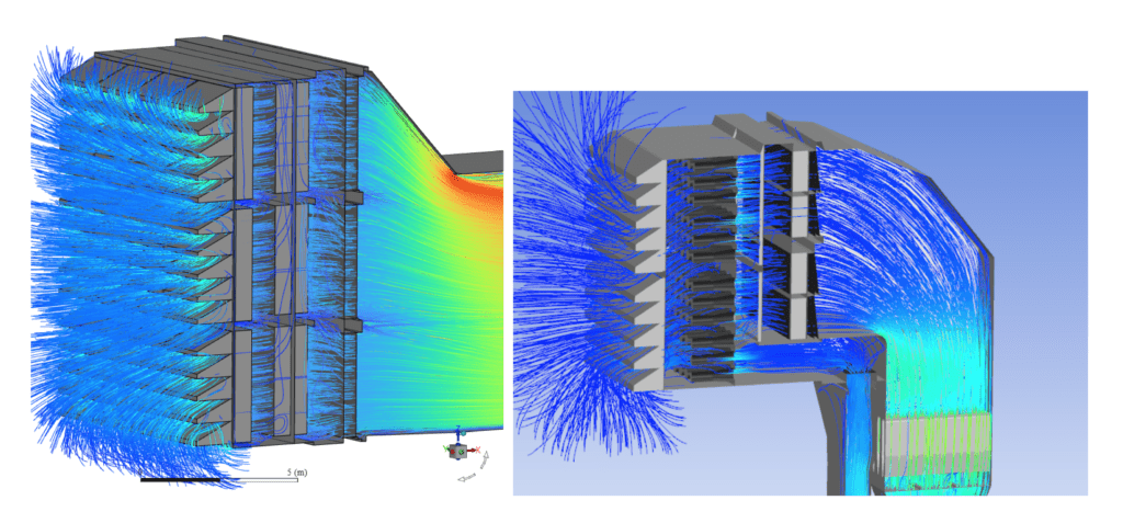

As impressive as these figures are, the research program may yet yield even greater things (Figure 3). Indeed, this extensive R&D program has expanded the knowledge frontier of filter aerodynamics, and what can and can’t be influenced by challenging specifications and optimizing filter technology. Possibly, rather than trying to go further in terms of size reduction, there may be additional opportunities in expand these breakthroughs to other sectors of the market.
3. Filter house computational fluid dynamics (CFD) models—static and pulse + evaporative cooling. Courtesy: Parker Hannifin Ltd.
