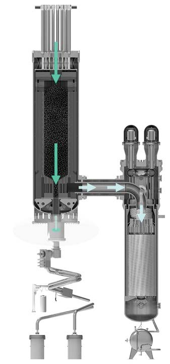

X-energy is developing its Xe-100 (Figure 3) advanced SMR along with TRISO- X fuel. Each reactor unit is engineered to provide 80 MW of electricity, according to X-energy, which said the design “is optimized in multi-unit plants ranging from 320 MW to 960 MW. The innovative and simplified modular design is road-shippable and intended to drive geographic scalability, accelerate construction timelines, and create more predictable and manageable construction costs.”
X-energy’s Xe-100 small modular reactor
Figure 3. This graphic shows the inner workings of X-energy’s Xe-100 small modular reactor
(SMR). Courtesy: X-energy
