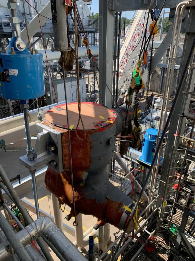

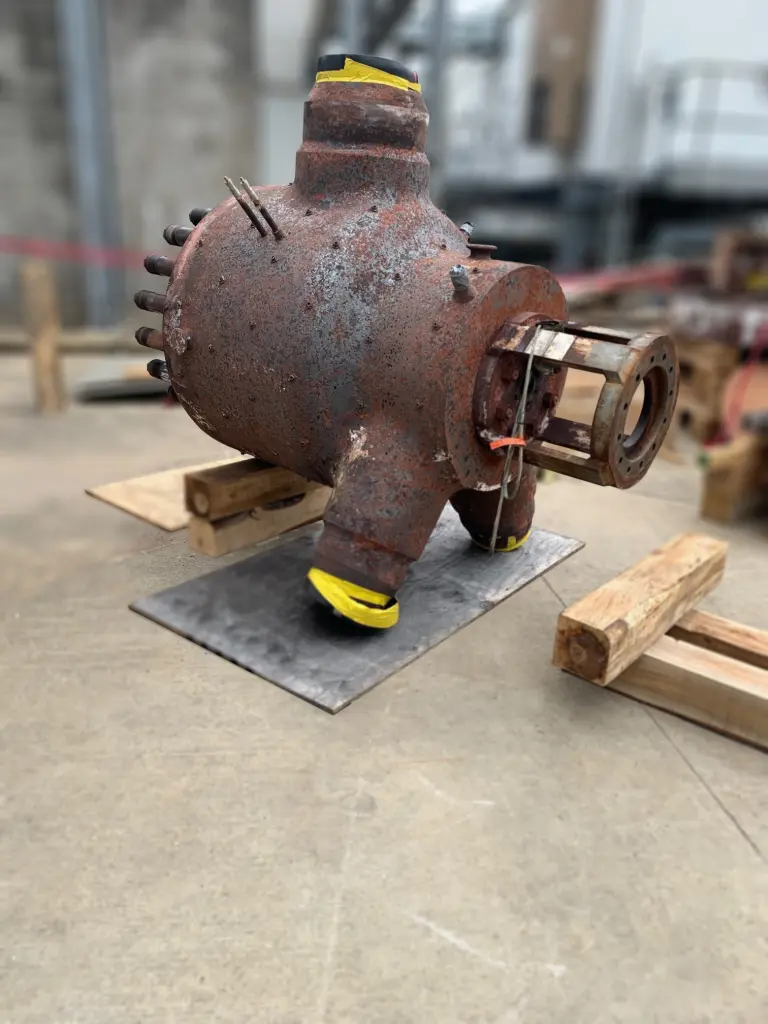

Replacement of the combined main stop / control valve (MSV/CV) was requested by the customer in response to a technical memo issued by the OEM relating to a material deficiency. The valve’s original body was a casting, which is prone to stress fatigue and cracking. As a result, the OEM recommended that the valve be replaced with one that has a forged body.
MD&A’s experts completely replaced the combined main stop and control valve assembly. The team provided engineering services for the MSV/CV replacement and outlet pipe modification work to accommodate the new valve assembly.
MD&A New-buckets-for-rows-L-1-and-L-0
A new monorail beam was installed to facilitate future CV actuator removal.
After installation, MD&A’s technicians performed several tests and inspections on both main stop and control valves to verify proper installation and assembly.  They also performed HP shell arm loading tests before and after the valve assembly was replaced. Radiography inspections were also conducted after the valve casing was installed, revealing some deficiencies that were remedied immediately.
OLD MSV/ CV Body
OLD MSV/ CV Body

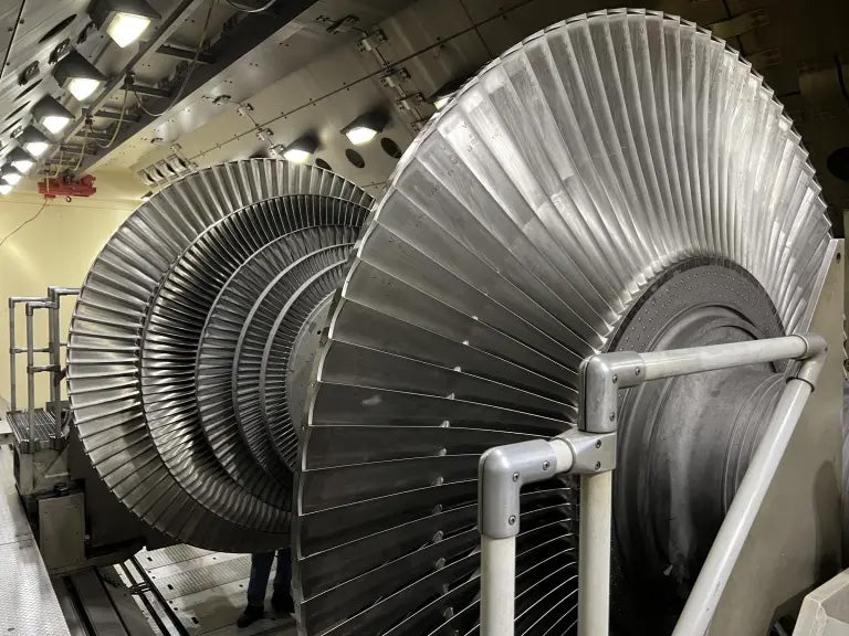

As part of planned work for this outage, MD&A’s experts removed and shipped the steam turbine LP rotor to MD&A’s Turbine-Generator Repair Facility for inspection and bucket replacement (which had been previously recommended by MD&A’s major inspection of the unit in 2020). The team performed visual inspection, blast cleaning, dimensional inspections, and NDE inspection of the entire rotor. The rotor was found to be in very good condition overall. Steampath inspection revealed minor FOD, minor moisture erosion, and minor rubs on packing seal lands.

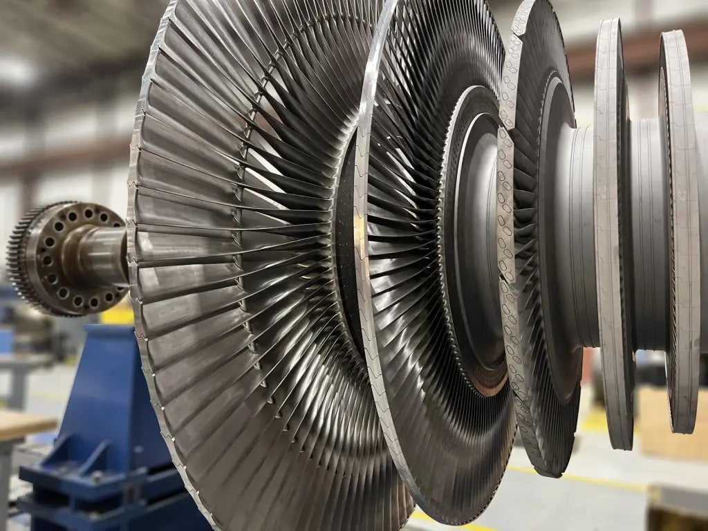

MD&A’s experts installed new buckets for rows L-1 and L-0 rows, according to the moment weight chart provided with the buckets. They required replacement due to wet steam erosion and OEM TIL recommendations.
Rather than replacing them with conventional components, our Advanced Continuous Cover Blades (CCB) were utilized. These blades are constructed using a mono-block blade structure, leaving fewer locations for corrosive deposits. They are less susceptible to stress corrosion cracking and demonstrate excellent vibration characteristics. These long blades provide up to 8% stage efficiency increase, without requiring diaphragm replacement. As part of their installation, MD&A’s technicians reamed all dovetail pinholes, and installed new pins.
After installation, covers for both stages were final machined as required to meet the stated requirements. The team also conducted minor repairs for stages 13 TE & GE to resolve FOD/impact airfoil damage.
Upon completion of the work, a high-speed balance of the rotor was performed at our Repairs Facility.

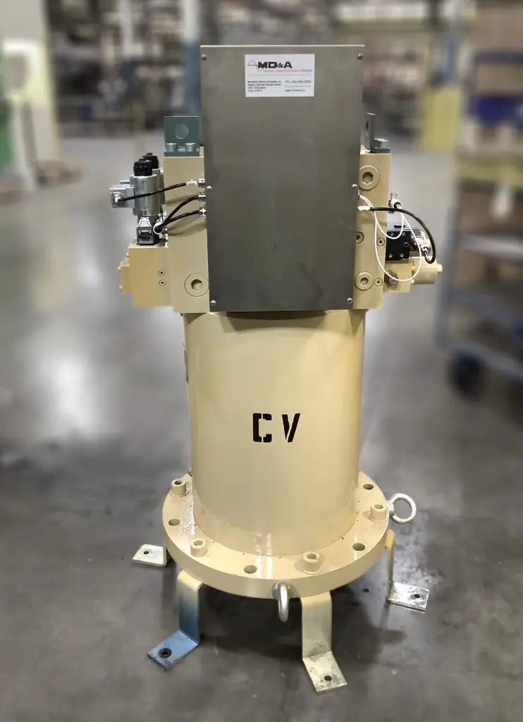

As part of the planned outage, MD&A’s team removed one Rexroth® Extraction CV actuator, two Mafag® IP admission valve actuators, and two Mafag® LP admission valve actuators.  They were shipped to MD&A’s Bearing, Seals and Hydraulics facility for disassembly, inspection, repair, reassembly, and testing.
MD&A Actuator
Cylinder & Spring Can
For the CV actuator, our experts rebuilt the servo, and tested, flushed, reinstalled the poppets, and replaced shaft seals and O-rings. All other main components of the actuator were found to be in good condition and reused.
MD&A Capture
New CV Acutator
For the IP and LP admission valve actuators, our technicians performed various repairs including chroming and grounding two of the shafts, polishing two of the cylinders, replacing a poppet valve on one unit, and installed new RVDT and packing glands on all.
Upon completion of reassembly, all actuators were tested and found to be properly functioning and free of leaks. The actuators were pressure tested at 110% and stroked and tripped several times.
