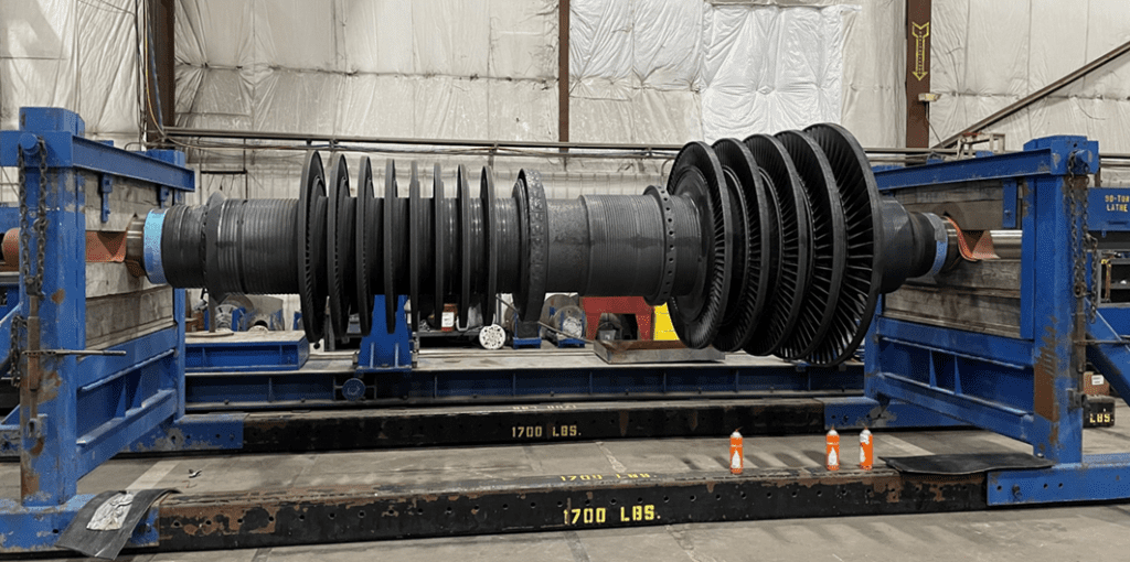

HP/IP Rotor Inspection
The process began with blast cleaning and inspection of the rotor by MD&A’s experts.  Visual, dimensional, and magnetic particle inspections (periphery and axial headshot) were performed prior to assessing any required repairs.

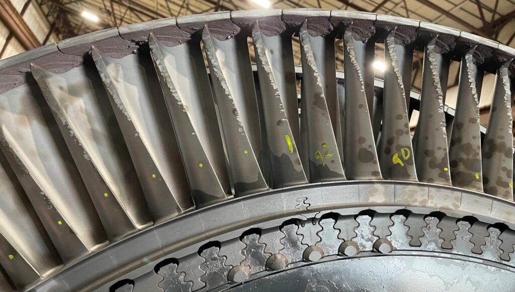

Prior to blast cleaning, stage 10 buckets were removed: both foreign object damage and solid particle erosion. Inspection revealed that there was foreign object damage (FOD) at every stage. On stage 1, damage was noted on the covers, roots, and tenons, while other stages had FOD primarily on the leading edges and some on the covers. Several stages had HVOF coating to the airfoils, while debris remained after blast cleaning beneath stage 11 and 12 covers. Raised material was noted on stage 14.

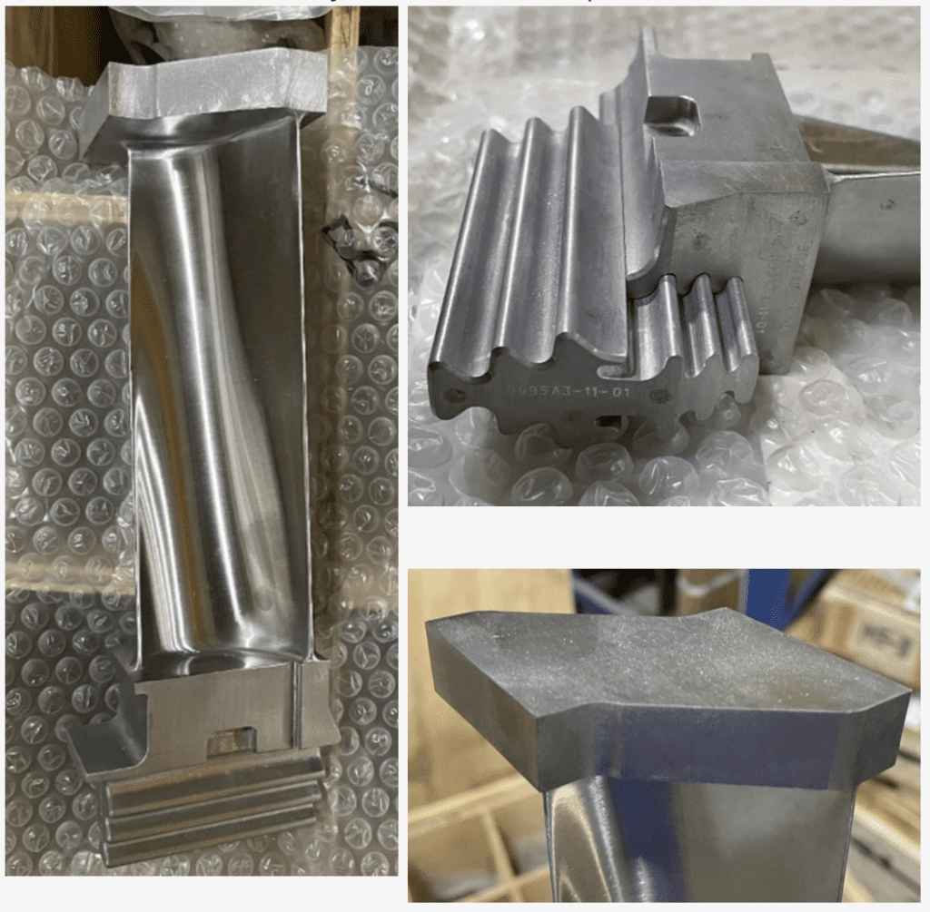

Bucket replacement was conducted at MD&A’s Turbine-Generator Repair Facility in St. Louis, MO. MD&A’s technicians replaced 90 standard buckets supplied by the customer, in addition to one auxiliary bucket, and a two-piece lock bucket.

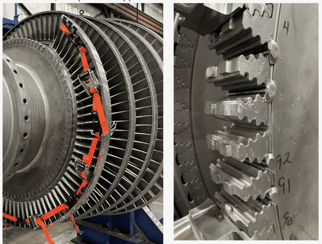

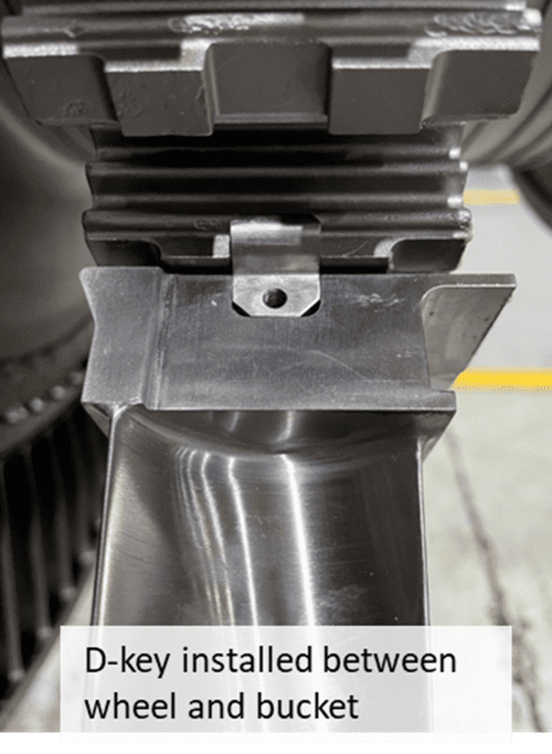

Five D-keys were supplied along with 2 special keys for the last bucket. These keys fit between the bucket root and the rotor groove and serve to fix the buckets axially. The removed D-keys had mechanical damage and needed to be replaced, however none were in stock. As this was a time sensitive job, MD&A’s machinists fabricated 82 standard D-keys in the shop. Reverse engineering measurements were then taken in preparation for the overhaul. New buckets were scanned to record geometry, and hand measurements were taken.

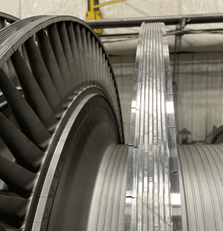

The process involved fitting new buckets with an interference fit, necessitating the tightening of bucket groups by MD&A’s technicians using heavy-duty straps. Rubber protection was employed to safeguard trailing edges during this process. The last 5 buckets were secured axially with twist-locks. The twist locks were secured by bending over the tabs. The 2-piece lock bucket also had a special key installed to fix the airfoil axially.
Shims were inserted post-bucket installation, before cover machining. Following machining, shims were removed. A low-speed balance was then performed with the control shaft installed. After completing these repairs, the rotor was cleaned, coated with lubricant, and plastic wrapped.

In addition to the major bucket repair for stage 10, several other repair and maintenance tasks were executed in response to the inspection findings and recommendation detailed earlier. Raised and loose material was removed off the covers, root, and tenons on stage 1. For stage 2 and 11, loose material was removed from the airfoils. For stage 3-9,12, and 13, foreign object damage was removed from the leading edges. Debris was removed from underneath the covers for stages 11 and 12, while raised material was removed off the rubbed root axial seal on stage 14. The T2 journal was skim cut.
