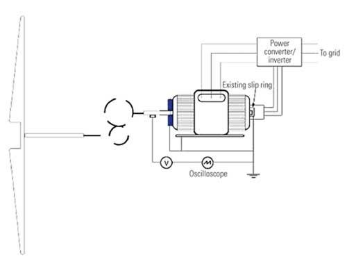

The first measurement, taken during full-power operation with a wind speed of 12.1 mph, established a baseline voltage (the system’s ground noise level) of 2.60 volts (peak-to-peak) from the 5.824-inch shaft of the tower’s doubly fed, asynchronous generator.

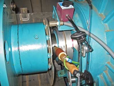

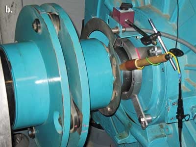

The crew then conducted eight more measurements in two series. The first series of readings measured the shaft voltage with all components engaged. The bearing protection ring and collar were on the drive end of the shaft, and the standard carbon block brushes were on the non-drive end (Figure 4a). For the second series of readings, the bearing protection ring was disengaged and the shaft collar was removed, leaving the non-drive-end carbon block brushes as the only shaft-current mitigation (Figure 4b).
4. Probe locations. Shaft voltages were measured on the drive end (top), where the protection ring and collar were located, with the original equipment manufacturer’s (OEM’s) shaft brushes on the non-drive end for a series of tests. For comparison, the protection ring and collar were removed (bottom), leaving only the OEM carbon block brushes to control drive shaft currents. Courtesy: Electro Static Technology

Results of the first series of tests of the turbine with the bearing protection ring installed show an average shaft voltage of 6.41 volts (peak-to-peak). Results of the second series of tests, in which only the spring-loaded carbon block brushes were used, showed an average shaft voltage of 41.35 volts (peak-to-peak). The difference between these figures, 34.94 volts, indicates that the bearing protection ring and collar successfully divert approximately 84.5% of the damaging current that remains on the tower’s generator shaft when the only bearing protection is from the carbon block brushes at the non-drive end (Figure 5).
Furthermore, the voltage wave form with the new ring and collar engaged was smooth, with no detectable discharge to the bearings, while the wave form without the ring and collar showed a bearing-current-discharge pattern with voltage peaks an average of 6.5 times higher. Also, conventional carbon block brushes apparently provide minimal protection, continue to allow current discharges in the generator’s bearings, and require frequent maintenance and replacement.
