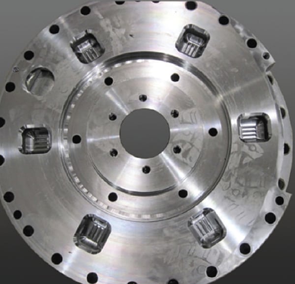

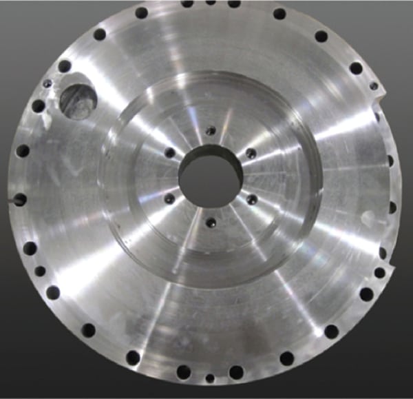

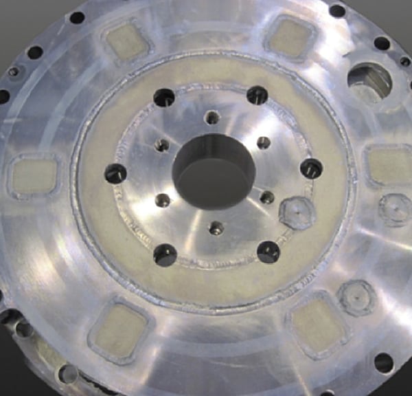

Primary End Covers. One of the first challenges the team faced was how to introduce an atomizing air cavity into the gas-only end cover. The team first believed this to be an easy task, as the dual-fuel nozzles already had the cavity installed. A closer examination of the covers revealed that the gas passage on the gas-only end covers was installed on the cold side of the end cover rather than on the hot side, as on the dual-fuel end covers. Unfortunately, the position of the cavity overlapped the atomizing air passage of the dual-fuel covers, making it impossible to merely install a passage similar to the dual fuels. The 3-D model allowed the team to identify a location in the assembly for the passage that did not affect the minimal wall thicknesses of the internal passages, nor did it reduce the cavity cross-sectional area (Figures 1 and 2).
1. Conversion begins. ProEnergy Services decided to convert a gas-only end cover (cold side) for a Frame 7 DLN1.0 to a dual-fuel end cover design. Courtesy: ProEnergy Services
2. Machine air passages. The gas-only end cover design with the new atomizing air passages installed. Courtesy: ProEnergy Services

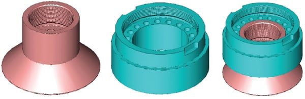

The location of the gas passage on the cold side also posed a problem for mounting the fuel blocks: The fuel blocks’ mounting bolts would now pass directly into the gas passage. This problem was solved by deepening the passage and installing isolation blocks (Figures 3 and 4).
3. Braze block mounts. Fuel block mounting locations were machined into the end cover. Courtesy: ProEnergy Services
4. Completed assembly. The end cover with the atomizing air passage and isolation blocks installed. Courtesy: ProEnergy Services

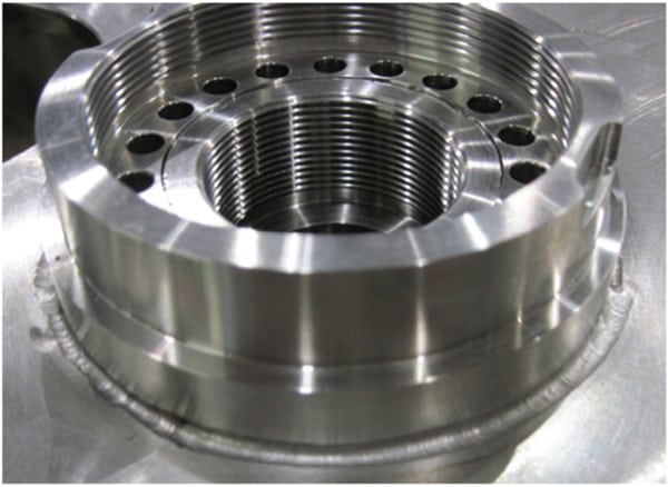

The team also took the opportunity to correct another problem on the assembly. During operation, thermal expansion of the midsection has caused the upper braze joint on each nozzle boss to crack. The team eliminated this condition by constructing the insert out of two pieces. Each of the two parts has only one point of retention, thereby reducing the stresses typically experienced by the boss (Figures 5 and 6).
5. Virtual parts. A SolidWorks model of the two-piece boss design. Courtesy: ProEnergy Services
6. Machined parts. The two-piece boss assembly installed. Courtesy: ProEnergy Services

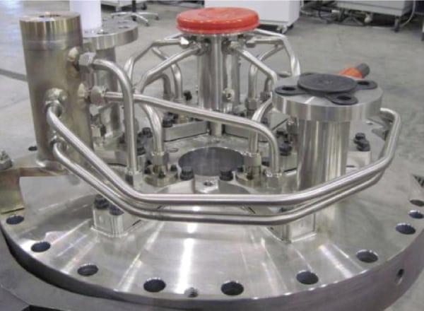

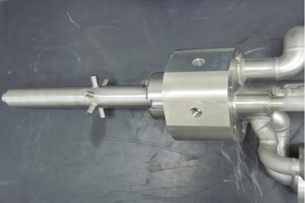

The solution to this problem was to insert and braze a sleeve between the ports. This approach required removal of the flame scanner inlet pipe to gain access to the area for this sleeve. Because there would be no access to the sleeve after assembly, the team opted to use a gold nickel palladium braze material to ensure the part sleeve joint would outlast the useful life of the secondary nozzle itself. After this modification was completed, the remaining secondary conversion work was uneventful (Figures 7 and 8).
7. End cover mod complete. Completed end cover with atomizing air piping installed for dual-fuel operation. Courtesy: ProEnergy Services
8. Nozzle mods complete. This secondary fuel nozzle has completed its conversion to dual fuel. Courtesy: ProEnergy Services
