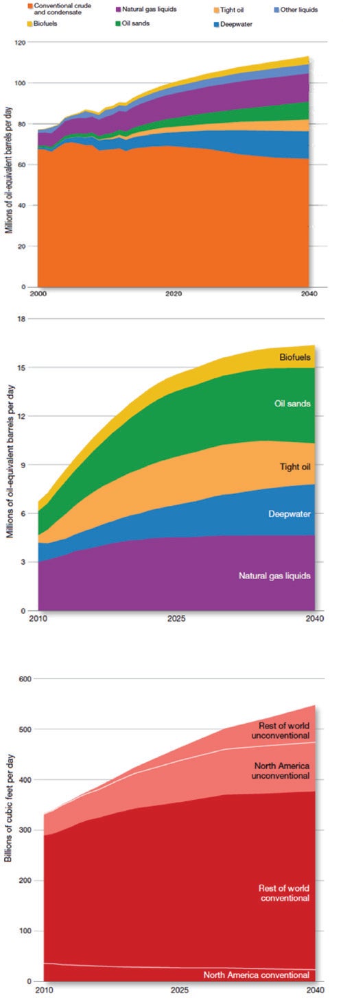

Next, contrast these production figures with what ExxonMobil forecasts for the rest of the world in a new report, “The Outlook for Energy: A View to 2040.” Tight oil production is expected to grow from 4.5 million bpd to around 9.5 million bpd in the U.S., and that accounts for the majority of global growth as well. Unconventional natural gas growth rises from 30 billion cubic feet/day to 160 cubic feet/day. The report notes that unconventional gas includes shale gas, coal bed methane, and tight gas, but that the major component is shale gas. If we assume half of this total is shale, it amounts to around 65 billion cubic feet/day of production in 2040 (Figure 1).
1. Tight oil and unconventional gas extraction and delivery is expected to grow worldwide. Electricity necessary to power this growth could total 100,000 MW to 200,000 MW, based on an extrapolation of the estimate for the Williston Basin. Courtesy: ExxonMobil
Obviously, these are forecasts, which are always fraught with potential error. And there isn’t necessarily a direct, linear extrapolation from the U.S. to the rest of the world. What is clear, though, is that if 2,500 MW is necessary for the production expected in the Williston Basin, then potentially between 100,000 MW and 200,000 MW may have to be added worldwide over the next 20 to 30 years. Some of this represents potential displacement of existing capacity. Economic growth and electricity demand in shale and tight oil regions could mean economic decline in other regions as families and workers migrate toward the opportunity. Still, it pays to remember that getting and delivering energy takes energy, too. There are two sides of the meter when assessing the growing symbiosis between natural gas and electricity.
