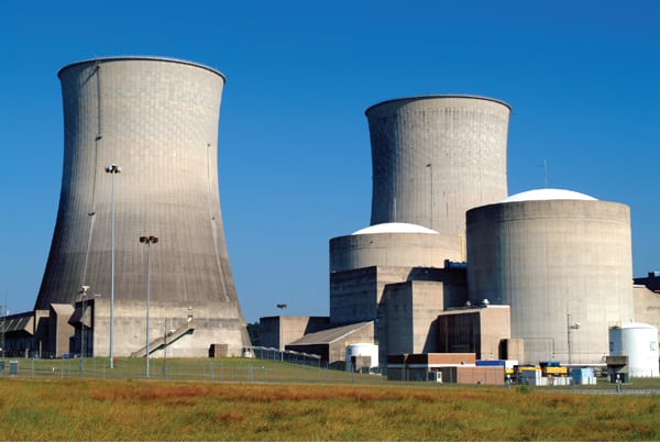

1. Vogtle under construction. Workers were compacting backfill for Unit 4 on November 4, 2010, when this image was shot. The Modular Assembly Building (far right) and the operating Units 1 and 2 are shown in the background. Courtesy: Southern Company

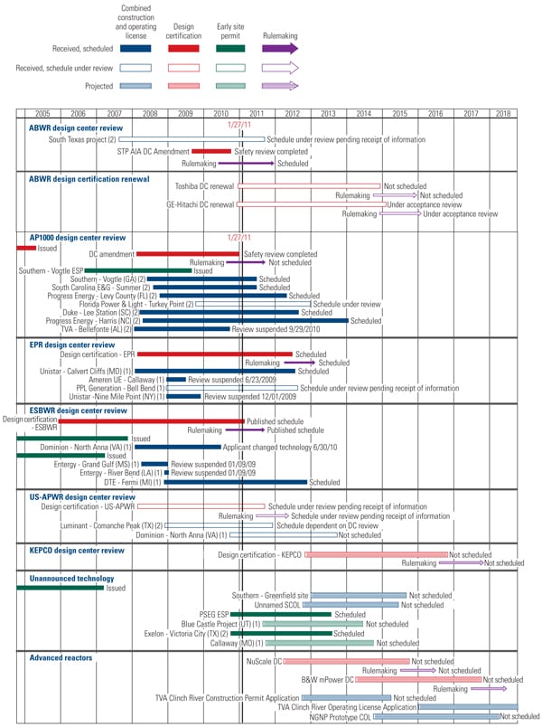

Four years ago, the NRC reported that it had “expressions of interest” from 16 companies for 32 new nuclear units that would be reviewed under the agency’s new combined construction and operating license (COL) process. Today, according to Magwood, the agency has merely a dozen active applications in hand (see sidebar), representing 20 units. These, unlike the flood of four years ago, represent “serious efforts. They are not for show.” Magwood’s clear implication was that a lot of the early applications were atomic window dressing.
The NRC’s highly touted new licensing process—designed to streamline regulators’ review—compresses the traditional review under Title 50 of the U.S. Code of Federal Regulations, which provides for one license to build the plant and another license to operate it once built, with a provision in Title 52 of the code. The new title allows the NRC to issue a “one-stop” license, combining construction and operation reviews. That makes taking a plant critical nearly automatic once it is built. So far, the new COL remains untried in its entirety.
The day the Platts nuclear conference opened, the NRC announced final plans for how it will conduct mandatory hearings under the COL process. While the law provides for hearings on contested licenses, the NRC decided some time ago that it will also hold separate hearings on all license applications, whether contested or not. In mid-February, the NRC said it will begin the mandatory hearings after its staff issues a final “Safety Evaluation Report and Environmental Impact Statement” for a COL application.
The NRC in a press release says it “intends to issue a decision on the uncontested issues within four months of the issuance of those reports, unless the reactor design referenced in the application is the subject of an ongoing design certification rulemaking. In this case, the commission would issue its hearing decision if and when the commission affirms the related design certification rule.”
Tennessee Valley Authority (TVA), which did so much to light the rocket under the first nuclear lift-off, will be a leader in the second expedition, TVA nuclear chief Jack Bailey made clear. TVA plans to resume construction on mothballed units at its Watts Bar plant in Tennessee (Figure 2) and at the Bellefonte site in Alabama. TVA held onto the construction license for Watts Bar, so resuming that project will be largely roadblock-free. The agency must apply for a new license for the Bellefonte project, because, Bailey explained, TVA relinquished the license when it stopped work at Bellefonte. Bellefonte was designed to use a Babcock & Wilcox pressurized water reactor, of the same basic design as the doomed Three Mile Island plant. TVA wants to replace that reactor with an advanced Westinghouse AP1000 unit.
2. Renovating Watts Bar 2.  In August 2007, Tennessee Valley Authority (TVA) began the $2.5 billion project to complete Unit 2 of Watts Bar Nuclear Plant by 2013 in order to add 1,180 MW to the TVA grid. Unit 1 was the last nuclear plant to enter commercial service in the U.S., in 1996. Construction on Unit 2 originally began in 1973 but was suspended in 1988. Courtesy: TVA
