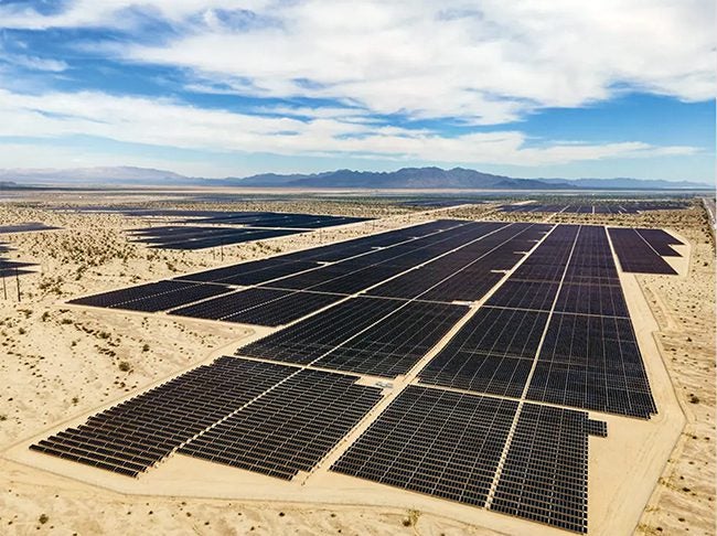

The source of growth is expected to shift in coming years, however. The report says utility-scale projects (Figure 1) will decline in prevalence over the next decade, and growth in distributed solar installations will be key to the industry’s continued dominance. “Policies like subsidies and tax credits will boost distributed solar adoption in large markets like the U.S., China, and India, while emerging regions like sub-Saharan Africa and Latin America will also see distributed solar growth to enhance energy security,” the report says.
1. The Oberon Solar + Storage project, located in Riverside County, California, is a utility-scale facility completed in November 2023. The site generates 679 MWp/500 MWac of solar energy and also features 250 MW/1 GWh of co-located storage. Courtesy: Intersect Power
