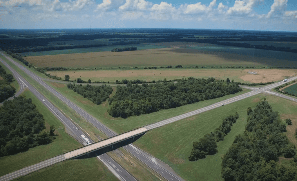

A filing with the Louisiana Public Service Commission shows that Entergy plans to build more than 2 GW of natural gas-fired power generation in the state, including a 1,500-MW facility in northeast Louisiana that would provide power for a large Meta data center operation in an area off Interstate 20 in Holly Ridge (Figure 1). Meta is the parent of social media’s Facebook; the company confirmed its intentions in a Dec. 4 news release, saying the data center would represent a $10 billion investment.

1. This land near Interstate 20 in Holly Ridge, Louisiana, would be the site of a data center complex for Meta, the parent of Facebook. Entergy Louisiana is proposing to build about 1,500 MW of gas-fired power generation at the site to provide electricity for the $5 billion data center operation. Source: Louisiana Economic Development
