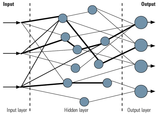

Neural networks take inputs from the environment and process them to determine patterns and relationships and then point to a directed output (Figure 2). In human intelligence, neurons in our brains learn how to respond to daily stimuli. Neural networks allow computers to artificially mimic this same process recognition and classification of data. The AI neurons are connected by varying strengths (as represented by various line weights in the figure).
2. Capturing experience. Neural networks artificially mimic the human brain in process recognition and classification of data. The complexity of the stimuli (input) determines the number and strength of the pathways (illustrated by line weight) that determine the result (output). Processing numerous connections in parallel and keeping track of the results allows the neural network to learn from “experience.” Source: Fluor Corp.
Although the diagram is simplistically shown in two dimensions, there are actually multiple layers—in space and time—for the connections. Depending on the complexity of the stimuli, there could be a few connections or an extensive network of connections. Processing numerous connections in parallel and keeping track of the results allows the neural network to “learn” from experience and store or memorize the end result. The network can subsequently retrieve millions of prior experiences quickly to make value judgments in similar circumstances in the future.
