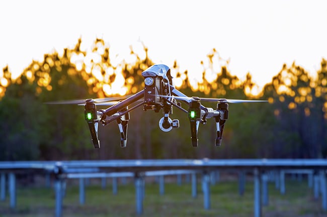

Image courtesy: AES Corp.

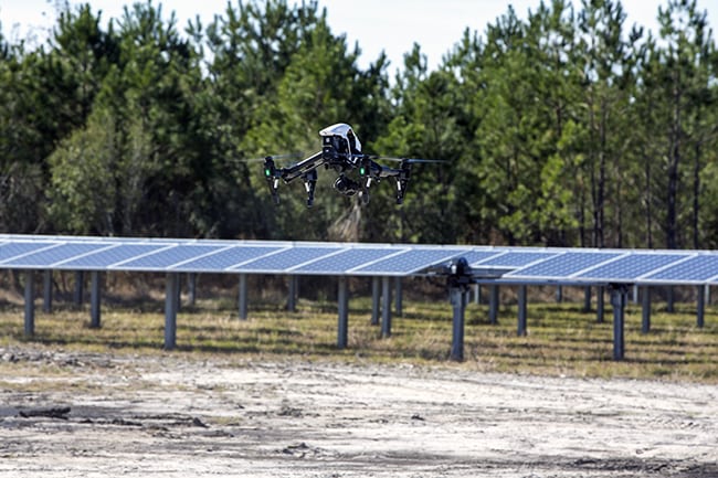

Unmanned aerial systems—drones—have quickly found their place in the power sector. But as the industry moves out of test cases and experiments, and into full implementation of drones, it is facing a whole new set of challenges and opportunities.

Maintenance Management. Facility owners, asset managers, and operation and maintenance contractors routinely deploy drone fleets to realize cost and operational benefits of aerial inspections today. However, solar panel inspections are growing more sophisticated as thermography and thermal orthomosaics evolve to pinpoint faulty panel infrastructure. A team of scientists from Purdue University, meanwhile, has created a drone system to automatically detect cracks or texture changes in steel components of nuclear power plants, alerting technicians about the potential danger.

5. Technical evolution. Solar panel inspections are growing more sophisticated as thermography and thermal orthomosaics evolve to pinpoint faulty panel infrastructure. Courtesy: AES
5. Technology evolution. Solar panel inspections are growing more sophisticated as thermography and thermal orthomosaics evolve to pinpoint faulty panel infrastructure. Courtesy: AES
