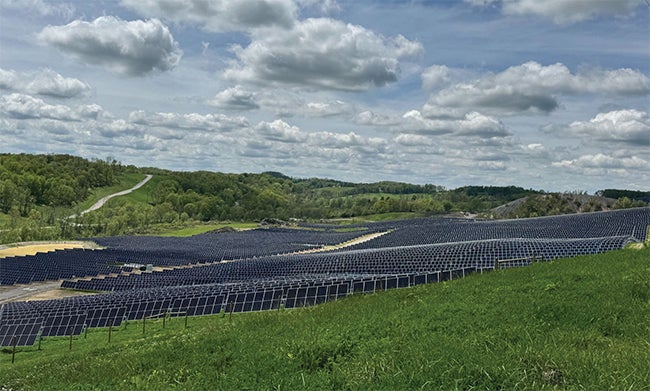

1. The challenging terrain of a former coal mine waste site in Pennsylvania called for an innovative tracking system in order to build a solar power installation on the land. Courtesy: Nevados
The Sarish Solar Project demonstrates how a challenging landscape (Figure 1) can still be utilized for a renewable energy project, in this case turning what some would consider an unbuildable site into an economically viable solar farm. Sarish showcases the potential of Nevados’ TRACE All Terrain Tracker (ATT), technology that supports solar energy development, enabling high performance on difficult terrain and earning the project a POWER Top Plant Award in the renewable energy category.

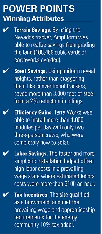

“Pennsylvania’s prevailing wage laws added labor cost pressure to an already challenging site. With the Nevados system, they were able to overcome the increased cost of prevailing wage labor with a system that was faster to install,” he said. Chandra noted that some of the main advantages gained by using Nevados’ ATT system included:
  • Allowing construction on 20% slopes with zero site grading, avoiding more than 108,000 yd³ of soil disruption.
  • Saving more than 3,000 feet of steel via consistent pile reveal heights, a 2% reduction in pile steel density across the site.
  • Enabling rapid installation by a team with no prior solar experience—up to 1,000-plus modules per day with just two, three-person crews. The modules were 655-W models from Canadian Solar.
  • Supporting pre-assembly for faster install and lower labor costs.
  • Qualifying the project for additional IRA tax credits with domestic content.
