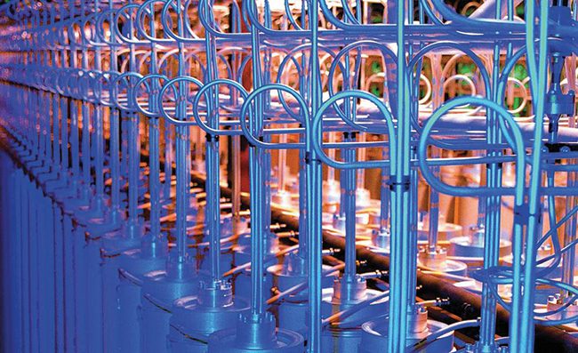

Nuclear fuel suppliers have begun stepping up to the challenge. Enrichment giant Urenco (Figure 1) is investing billions of dollars to deliver HALEU enrichment capabilities in the UK and U.S. by the mid-2020s, as well as developing a dedicated HALEU enrichment plant in the UK, targeting the early 2030s for initial material availability, said Magnus Mori, head of Market Development and Technical Sales at Urenco. “It’s a paradigm change, it’s a shock to the system.” But it poses immense risks, he suggested. “We can take orders, but we don’t have the momentum, the critical mass for a private investor to take all the investment risk,” he said.

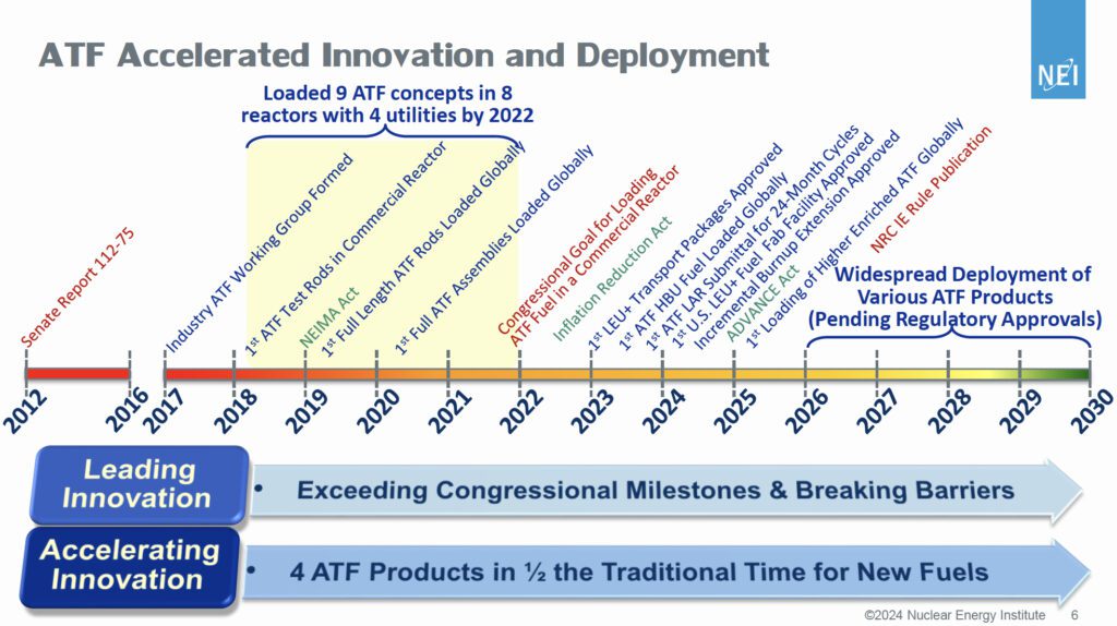

An especially notable triumph for the nuclear industry over the past decade has been its development and commercialization of accident-tolerant fuels (ATFs). An industry concept used to describe new technologies in the form of new cladding and/or fuel pellet designs, ATF technologies essentially leverage new materials that improve fission product retention and are structurally more resistant to radiation, corrosion, and high temperatures. And because they could be paired with fuel enrichments of up to 10% (LEU+), they could potentially extend the time between refueling from 1.5 to 2 years and reduce the amount of fuel needed by about 30%, resulting in less waste and used nuclear fuel.
While ATF technologies have been under development since the early 2000s, they received a marked boost in the wake of the March 2011 Fukushima accident as the Department of Energy (DOE) aggressively implemented plans under its congressionally mandated Enhanced Accident Tolerant Fuel (EATF) program to develop ATFs for existing light water reactors (LWRs). The DOE championed different fuel designs from three major fuel vendors: Framatome, General Electric/GNF, and Westinghouse/General Atomics. But the push for ATF has regained dramatic momentum in recent years, driven by a confluence of policy, regulatory, and market forces.
Advancements have generally aligned with broader nuclear sector goals, including commercialization and economies of scale, establishing a robust regulatory infrastructure, and maintaining international leadership in fuel technologies. “We’ve hit the limits of 62 GW-days per metric ton uranium burnup and 5% enrichment,” explained Al Csontos, director of Fuels at the Nuclear Energy Institute (NEI), in October. “We now want to go higher,” with the goal of reaching 10% enrichment and 75 GW-days per metric ton burnup for two-year cycles.
The economic implications are profound, he noted. Longer fuel cycles could reduce the frequency of refueling outages, which are both costly and disruptive. “If you go to 24-month cycles, now you’re doing one outage every year,” said Csontos. “At sites like Vogtle, where there aren’t enough hotel rooms nearby to handle all the contractors during outages, fewer outages would make a big difference,” he said. Higher burnup levels also address a critical issue in waste management. “You can have more fuel efficiency, less waste,” Csontos added. “It’s about using the plants differently to produce more power.”
Progress has been swift. Industry loaded its first ATF lead test assemblies (LTAs) in reactors in 2018 (at Southern Co.’s Hatch plant, which included two types of GE/GNF ATF cladding designs. By 2023, it had marked a stunning list of milestones, including the Nuclear Regulatory Commission’s (NRC’s) first-of-a-kind approval for the use of ATF fuel. More recently, in October 2024, Framatome’s GAIA fuel assemblies with PROtect Enhanced Accident Tolerant Fuel (E-ATF) completed their third 18-month fuel cycle at Plant Vogtle in Georgia, marking the conclusion of a four-and-a-half-year evaluation. That milestone marked “a lifecycle of operation of the world’s first full-length PROtect E-ATF fuel rods with both pellets and cladding in an operating pressurized water reactor,” Framatome noted.
Accident-tolerant fuels have achieved key milestones, including deployment in commercial reactors, regulatory approval for higher burnup, and advancements in cladding and enrichment technologies. Courtesy: NEI (Oct. 2024)
However, to meet the growing power demand driven by electrification and digitalization while ensuring the reliability of the existing fleet, new urgency is ramping up to expand deployment of ATF and LEU+ technologies, Csontos suggested. Utilities require up to 13 GW of additional capacity by 2030, and new nuclear projects are still a decade away from completion, he noted. A recent NEI survey of 56 nuclear sites estimated more than 70% have a level of interest or are planning one or more uprates with a combined capacity increase of 3 GWe, he noted. About half of the nation’s fleet, meanwhile, has “varying interest or plans” for one or more of the enabling changes associated with ATF, LEU+, extended fuel cycles, and risk-informed Loss of Coolant Accident (RI-LOCA) methodologies, with deployment targeted in the 2028 –2030 timeframe, he said.
Industry remains, so far, on track to deploy batch quantities in the mid-to-late 2020s. However, for now, the NRC’s regulatory path for efficient licensing for ATF/LEU+/high burnup fuels is targeting a 2027 timeframe. This includes the critical “Increased Enrichment Rulemaking,” which is designed to take “the top off of the 5% enrichment limit,” Csontos said. The regulatory change will be essential to accommodate the industry’s move toward enrichment levels of up to 10% for LEU+ fuels, with the potential to reach up to 20% for advanced applications, he noted.
