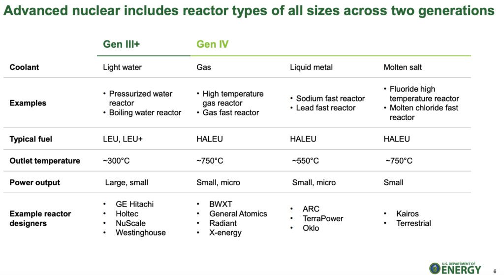

The NRC refers to non-light water reactor (non-LWR) designs as advanced reactors. “These reactors will use different technologies from existing operating reactors such as passive safety features, using different fuel or coolant, or scaling the entire reactor smaller,” it says.
The 2001-founded Generation IV International Forum (GIF), a global collaboration advancing next-generation nuclear R&D, describes these technologies as Generation IV (Gen IV). Compared to Gen II and Gen III reactors, Gen IV reactors employ advanced materials and innovative designs, such as fast neutron spectrums, closed fuel cycles, and high operating temperatures, enabling applications beyond electricity generation, such as hydrogen production and industrial heat.
Advanced reactors generally fall into two categories: Gen III+, which are LWRs, and Gen IV. The Generation IV International Forum (GIF) is exploring six advanced reactor technologies: Gas-Cooled Fast Reactor (GFR), Lead-Cooled Fast Reactor (LFR), Molten Salt Reactor (MSR), Sodium-Cooled Fast Reactor (SFR), Supercritical Water-Cooled Reactor (SCWR), and Very High-Temperature Reactor (VHTR). Source: DOE
Advanced reactors generally fall into two categories: Gen III+, which are LWRs, and Gen IV, generally non-LWRs. The Generation IV International Forum (GIF) is exploring six advanced reactor technologies: Gas-Cooled Fast Reactor (GFR), Lead-Cooled Fast Reactor (LFR), Molten Salt Reactor (MSR), Sodium-Cooled Fast Reactor (SFR), Supercritical Water-Cooled Reactor (SCWR), and Very High-Temperature Reactor (VHTR). Source: DOE
