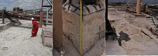

2. This series of photos illustrates an improperly designed block and concrete fire barrier. Courtesy: Fire Barrier Experts
Designers must consider several key design factors to ensure fire barriers provide maximum protection. One of the primary considerations is the 50-foot rule, which refers to the recommended minimum distance between transformers, control buildings, and critical equipment to prevent damage from fire and explosion. Fire barriers should be placed to isolate equipment while maintaining this safety distance wherever possible. When space constraints make the 50-foot rule challenging, fire barriers act as a crucial mitigation measure by compensating for closer proximity.

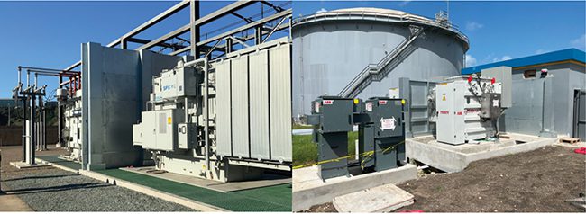

Hydro Dam Waterway Project. This project highlights how fire barriers can be effectively installed to protect critical transformer-to-transformer assets near water bodies. The key takeaway was the critical importance of proper barrier placement in areas vulnerable to environmental risks, such as flooding or water damage, which can significantly exacerbate fire incidents. Barriers in this setting will contain fire and prevent contamination from spreading to nearby water resources (Figure 3).
3. Deluge sprinkler systems around waterways have been shut down and removed because of the environmental issues associated with an unplanned release or even their use in an event. This series of images shows systems that were brought into compliance with fire barriers designed to fit in tight spaces to provide the required separation. Courtesy: Fire Barrier Experts

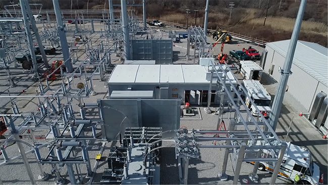

Critical Substation-to-Control Building Project. In this project, fire barriers were strategically placed to protect a substation near an adjacent building. The lesson from this project was the effectiveness of fire barriers in preventing collateral damage to nearby structures. Without barriers, fire spread could have easily caused the loss of transformer assets and the adjacent building, extending downtime and repair costs. These applications highlight the need for barriers in mixed-use environments where electrical infrastructure is near other facilities (Figure 4).
4. Fire barriers are also effective in preventing the spread of fires to nearby transformers and infrastructure, especially when equipment is positioned in close proximity as shown in this series of images. Courtesy: Fire Barrier Experts
