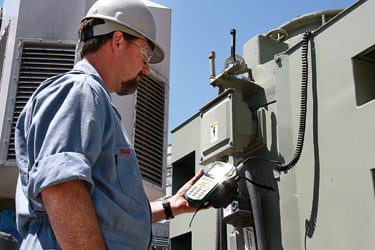

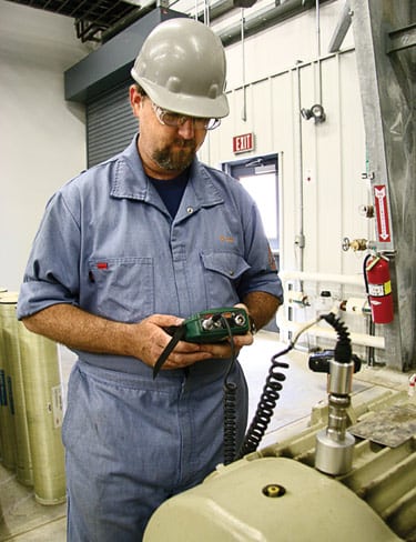

Because elevated levels of vibration can indicate that a piece of equipment is on the road to failure, Calpine plants watch that parameter like a hawk. Vibration readings are collected from all turbines, key oil and water pumps, and cooling fans at a plant once a month using Entek Enpac handheld data collectors from Rockwell Automation (Figure 2). The readings are then trended to facilitate analysis (Figure 3).

3. Shake, rattle, and roll. Thorp takes a vibration reading from a pump whose repair records he’s seen on-screen. Courtesy: Rockwell Automation
