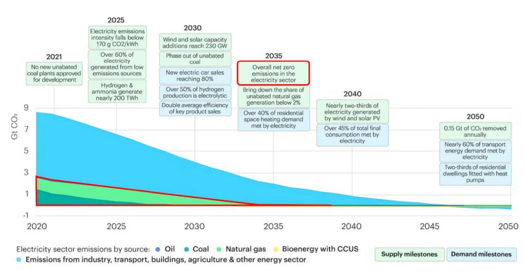

A recent study commissioned by the Benelux General Secretariat on the forum’s behalf analyzed several trends gleaned from existing scenario assessments and technical reports, and it lays out 12 “convictions.” Foremost among them is that the power sector will need to be decarbonized as “early as possible, ideally by 2035,” with carbon intensities below 50 grams/kWh. The 2035 date is based on an International Energy Agency (IEA) net-zero scenario rolled out in 2021, and it was also endorsed by the G7 at their 2022 summer summit. The U.S., notably, has set a similar goal of 100% carbon pollution-free electricity by 2035.
G7 energy-related emissions and electricity sector milestones in the Net Zero Emissions by 2050 Scenario. Source: (IEA, 2021).
