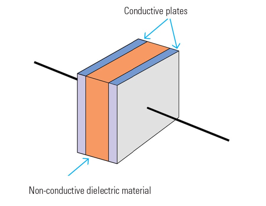

A capacitor is made up of two conductive plates separated by a non-conductive dielectric material (Figure 2). Dielectric materials are categorized by their dielectric constant (DK), which is a number that is related to the material’s ability to store a capacitive charge. The higher the dielectric number, the more capacitance it can store.

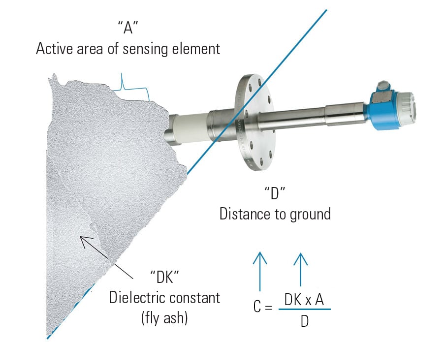

Capacitance technology for level measurement uses this same basic concept. In the case of a point level measurement, the hopper becomes a variable capacitor. The sensing element becomes one conductive plate, the hopper becomes the second conductive plate, and the material being measured is the dielectric.
The formula for capacitance is:
C = DK x A / D
where:
C is the capacitance,
DK is the dielectric constant (Note: the dielectric material in a fly ash hopper is the fly ash itself),
A is the area of the active portion of the sensing element, and
D is the distance between the active sensing element and ground (the hopper wall).

Figure 4 shows the sensing element covered with the dielectric material (fly ash). As the fly ash covers the active portion of the sensing element, it displaces the lower dielectric material (air) between the plates of the capacitor. This change from lower to higher dielectric material between the plates causes the capacitance to increase. The output of the point level switch changes from the uncovered to the covered state when the increasing capacitance exceeds the switch point.

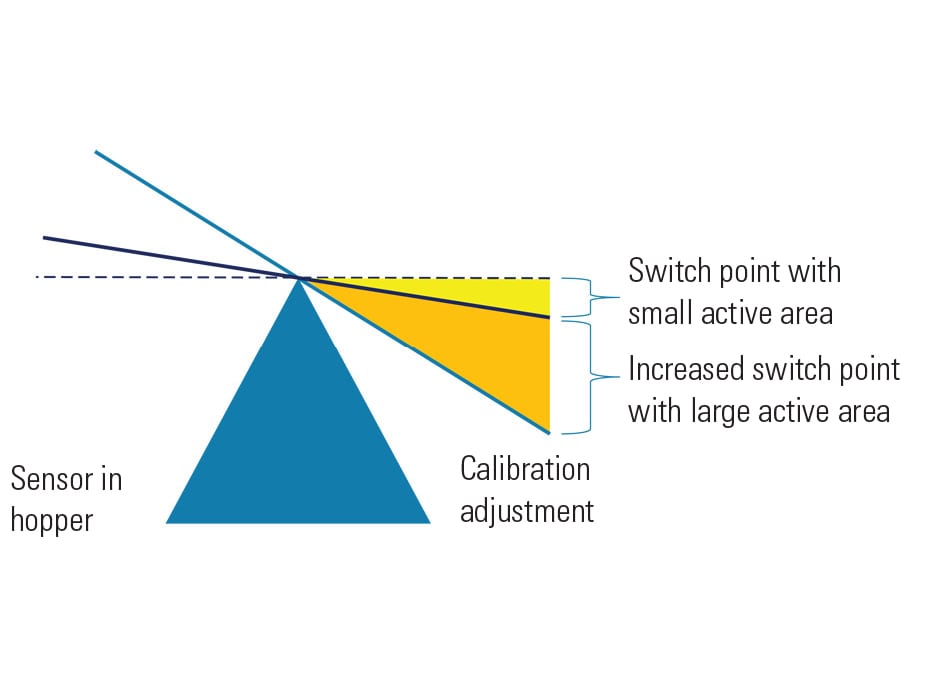

The key to using capacitance technology for point level measurement is maximizing the amount of capacitance generated. The reason for this is that by generating more capacitance we can make the switch less sensitive and thus more stable and reliable.
Increasing the active area (A) of the sensing element by making the active plate larger results in more capacitance being generated (that is, DK x A will be greater). With a larger active area, we can set a larger switch point. In other words, we have a larger dead band, as the difference in the capacitance value between the uncovered and covered conditions is much greater.
This is important because the capacitance point level switch is like a balance bridge. On one side of the bridge is the sensing element in the hopper. On the other side of the bridge is a tuning adjustment. There are two balance bridges shown in Figure 5. The switch point adjustment with the smaller active area, can only add a small switch point. However, by increasing the active area of the sensing element, a larger switch point adjustment can be used making the switch more stable.
5. A balancing act.
A larger sensing area makes the capacitance switch more stable. Courtesy: Endress+Hauser
Stability in a capacitance switch is everything. An unstable switch will have false trips due to coating and environmental changes inside the hopper. Anything that affects the sensing element side of the switch, such as coatings, will increase the capacitance on that side of the bridge. If the increase exceeds the switch point, the switch will show a covered state, or false trip.
