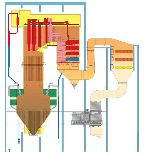

The B&W VTUP downshot boiler arrangement is illustrated in Figure 1. The unit is a two-pass once-through supercritical boiler with a vertical tube membrane water wall furnace with a parallel downpass. Reheat steam temperature is controlled by biasing flue gas between the reheater and primary superheater paths in the downpass. Major dimensions are shown in Table 1.
1. Jinzhushan 3 VTUP downshot boiler. Courtesy: B&W PGG
Table 1. Jinzhushan Unit 3 boiler dimensions. Source: B&W PGG

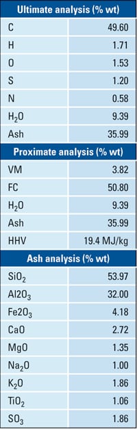

The coal is delivered from a mine near the plant. The design coal is unique, and its characteristics significantly influenced the boiler design. The ash is primarily silica and alumina, which exhibits a very high ash fusion temperature, minimizing slagging concerns. However, because silica and alumina are very erosive in nature and the total content of the ash is very high, gas velocities through the convection heating surface were designed to be very low, approximately 7.5 meters per second.
Table 2. Jinzhushan Unit 3 fuel analysis. Source: B&W PGG

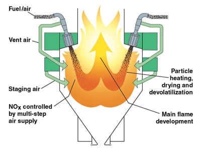

Low-volatile anthracite requires a hotter furnace to sustain combustion compared to more common, higher-volatile, lower-rank coals. The downshot furnace with refractory-lined burner zone provides an effective combination of long residence time and high temperature. The burners fire downward into the refractory-lined zone of the furnace. The combustion products then turn upward to leave the burner zone, as shown in Figure 2. As the flame turns up to exit the lower furnace, the char reactions return heat to the ignition area, increasing the effectiveness of the combustion process. The enlarged lower furnace also provides extended residence time of the fuel particles, allowing the slower-burning char to burn out more completely.
2. The downshot furnace. Source: B&W PGG

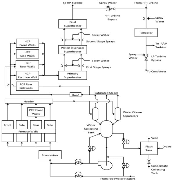

A schematic of the boiler water/steam and startup system arrangement is shown in Figure 4. The startup system equipment consists of two steam water separators, a water collection tank, a boiler circulating pump, and the associated piping and control valves to return the fluid from the water collection tank to the economizer inlet.
4. Steam/water circuitry and startup system. Courtesy: B&W PGG
During startup, the unit is operated much like a drum boiler, where water is recirculated to maintain a minimum flow through the furnace equivalent to 30% of full load flow. The system is similar to a pumped circulation drum boiler with the steam water separators and the water collection tank functioning like the steam drum. The water flowing through the furnace is a combination of water from the water collection tank and boiler feedwater. The boiler feed pump controls the total flow through the furnace so the minimum required mass flow is maintained.
Steam generated through the furnace circuits is separated from the water in the vertical separator, routed to the superheater, and then to either the steam turbine or the turbine bypass system. The water from the vertical separator is returned to the water collection tank and then to the circulating pump. The 381 valve, located at the discharge of the circulating pump, controls the flow proportionally to tank level to maintain the water inventory in the collection tank. Water is also recirculated from the pump discharge to the collecting tank to ensure that minimum flow required through the pump is maintained.
Above the minimum boiler load (or Benson load) the unit switches to once-through operation. The circulating pump is taken out of service but is kept pressurized. A small flow of feedwater from the economizer outlet is routed to the circulating pump inlet and back to the separator to maintain the components in the ready state for use during shutdown.
