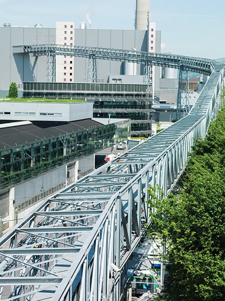

The pipe conveyor system not only protects the environment from falling items during transport, but it is also able to navigate long distances (Figures 1 and 2) and tight curve radii. Due to this characteristic, considerably fewer transfer towers are required compared to other belt conveyors (Figure 3). This allows for substantial cost savings for the customer, and the system can be easily customized to the individual routing.
PWR_040115_FOM_Fig1
1. A long and winding road. Due to its ability to negotiate curves, the pipe conveyor system can be optimally designed for any plant layout. Courtesy: BEUMER Group GmbH & Co. KG

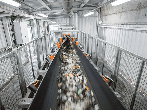

Similar to a conventional belt, the feeding area of the pipe conveyor is open (Figure 4). After a certain distance, which depends on the pipe diameter or belt width, special idlers mold the belt into the desired closed shape. From this point on, the closed belt runs along the entire conveying distance, through what are known as panels and partition plates.
PWR_040115_FOM_Fig4

Six rollers are installed in a staggered arrangement on each of these panels for the upper and lower strands. At the end of the conveyor line, the belt opens naturally and discharges the material. In the return strand, the belt is rolled back into its tubular shape.
