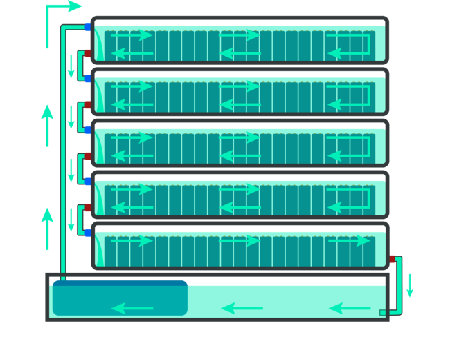

Immersion cooling technology involves fully submerging battery cells in a non-conductive dielectric fluid, establishing a highly efficient direct heat transfer pathway. This process effectively prevents the formation of thermal hotspots that lead to degradation and runaway conditions.
Unlike conventional air or liquid plate cooling, immersion cooling directly contacts the entire battery cell. This continuous and uniform temperature management throughout the battery array dramatically reduces battery degradation and fire risks before they can emerge.
Additionally, EticaAG’s immersion cooling system (Figure 1) is integrated with the Battery Management System (BMS). If the BMS detects any rise in temperature beyond normal operating thresholds, it automatically activates a proprietary circulation system. This circulation mechanism increases fluid movement around the affected battery cells, accelerating heat removal and restoring safe thermal conditions before a critical situation can develop.
1. LiquidShield’s immersion system and system circulation ensures uniform thermal management across every module. This is what the next generation of fire safety and resilience looks like. Courtesy: EticaAG
