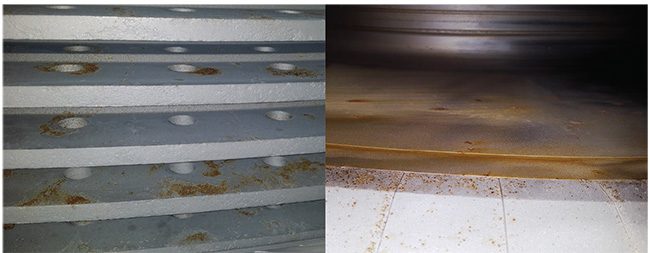

1. These images show flash rust on a turbine after initial cleaning attempts, before the use of a stronger rust removal agent. Courtesy: Cortec
Unfortunately, some power plant environments set turbines up for failure. Warm, humid sea air leaves behind salt deposits or flash rust (Figure 1) on turbines at coastal power plants. Harsh steam carrying hydrogen sulfide, or H 2 S, and minerals from the ground wreaks havoc on equipment at geothermal plants.

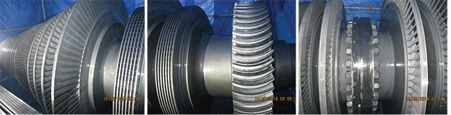

2. These images show turbines after being cleaned with rust removal and corrosion protection agents. In each case, the turbine was treated using VpCI-422, VpCI-414, and ElectriCorr VpCI-239. Courtesy: Cortec
ElectriCorr VpCI-239 (Figure 2) has become a favorite for many because of its versatility. Not only does it offer a quick layer of corrosion protection, but it also doubles as a cleaner that can be used to remove light rust or grime before spraying on the final layer of protection and leaving it to dry. Once the turbine is started, the heat and moisture of the steam environment will rinse the coating away in about 30 seconds without system interference.
ElectriCorr VpCI-239 proved to be a lifesaver for the Turkish power plant mentioned above. Initially, the problem was salt buildup on the rotor, so workers took the turbine out of the casing and blasted off the salt following original equipment manufacturer (OEM) recommendations.
However, by the time they were ready to return the turbine to the casing, the turbine had rusted, requiring another cleaning. The same problem happened several times because of the high-chloride, moisture-laden environment. Neither the suggestions of the OEM nor the project’s architectural engineering group worked. They simply were not able to find a way to keep the rust off. Finally, they consulted an expert at Cortec who had seen similar problems.
Following his recommendations, they used VpCI-422 (a less-viscous version of VpCI-423) for rust removal and VpCI-414 (diluted) for rinsing, neutralization, and flash rust prevention. Once the surface was dry, they sprayed it with ElectriCorr VpCI-239. Because of the previous difficulties, the facility manager insisted workers leave the turbine on the laydown deck for a week to make sure it stayed rust-free. Only then did they install it, finally satisfied with a solution that met their needs.
