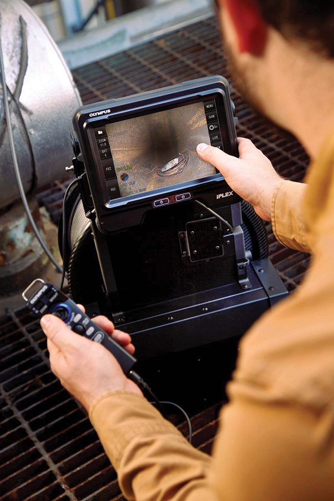

Advanced Features of the IPLEX GAir Video Borescope
1. The IPLEX GAir video borescope system offers inspectors the ability to quickly identify issues, facilitating faster decision-making and targeted maintenance. Courtesy: Evident |
The IPLEX GAir video borescope (Figure 1), designed for nuclear plant applications, provides several key advantages that make it particularly suited for use in high-radiation environments. These include:
- Radiation Resistance. The IPLEX GAir’s insertion tube is designed to withstand high levels of radiation, continuing to function effectively even after exposure to up to 1,400 gray (Gy) of radiation (equal to about 1 sievert). This durability helps ensure that the borescope remains operational for extended periods, even in highly radioactive environments. For example, insertion tubes that use optical fibers in the tip illumination can yellow with exposure to radiation, which causes it to absorb light, thereby reducing the light intensity. The LED illumination of the GAir’s optical tip adapter eliminates this problem as it does not contain fiberoptics.
- Long-Distance Inspection. With a 30-meter (100-foot) insertion tube, the IPLEX GAir enables inspections from a safe distance, minimizing radiation exposure for personnel. Its wireless capabilities further enhance safety, allowing the device to be operated from up to 100 meters away using commercially available repeater systems.
- Replaceable Insertion Tubes. In high-radiation environments, such as dirty water-filled pipes, the insertion tube may become contaminated or degraded. In some cases, decontaminating the equipment may be considered too risky for the health of the workers, or too costly, so the plant may opt to sacrifice the insertion tube, leaving it permanently in the radiation area. Regardless, the IPLEX GAir’s replaceable insertion tube can be swapped out quickly onsite, reducing inspection downtime and limiting the costs associated with radiation-exposed equipment.
- Optimal Illumination and Imaging. The IPLEX GAir features an advanced LED optical tip adapter that provides bright, uniform lighting, essential for inspecting dark, confined reactor spaces. Its WiDER image processing system delivers clear, high-contrast images, making it easier to detect defects such as cracks, corrosion, or wear. Additionally, the tip adapters can be swapped easily to accommodate specific inspection needs. Adapters with different optical characteristics, including a wide field of view, are available. Although these tip adapters are designed for drop resistance, protecting the lens within a robust metal frame, if a lens is damaged onsite, the optical tip can be replaced so inspection can continue.
- Efficient Handling. The IPLEX GAir’s pneumatic articulation system, combined with an integrated air compressor, makes the equipment easy to carry and use in the field. Its gravity-sensing technology automatically orients images on the display, reducing confusion during inspections and speeding up the process.
