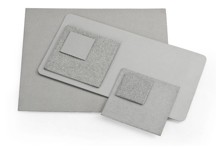

The most efficient electrolyzer design, however, combines thinner membranes with the implementation of perforated titanium sheets instead of conventional felt materials. Manufacturer investment in PTL has led to the creation of titanium PTLs (Figure 1, titanium sheets) as thin as 0.010″ that allow for lower oxidation rates, smaller footprints, and better resistance to bending and cracking. With this combination, PTLs can provide better thermal/electrical conduction and mechanical support, along with pathways for both reactant liquid water delivery to the catalyst layer and effective gas removal from the reaction sites to the outlet.
1. Porous transport layers (PTLs) from Mott are preferred in electrolysis applications due to an ultra-smooth design resulting in improved catalyst utilization and extended stack lifetime. Courtesy: Mott Corp.
