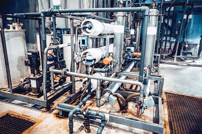

Reverse osmosis (RO) is a vital water purification technology used in various applications such as boiler feedwater treatment, cooling water systems, and wastewater recycling. The feedwater for RO can originate from municipal sources, wells, rivers, lakes, or even seawater. Here’s an overview of the reverse osmosis process, particularly as it’s applied in power generation (Figure 1).
1. An industrial reverse osmosis system includes pre-treatment, filtration, and membrane components, as well as pumps and controls. Source: Envato Elements
