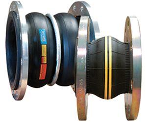

Arch Type Rubber Expansion Joints
Arch type rubber expansion joints are named from the thick area of elastomer molded into the shape of an arch. The carcass of the joint between the arch is usually supported by metal rings or wire to resist pressure.
Typical arch type rubber expansion joints are single wide arch and multiple wide arch types, the latter for use in longer length joints. As the length of an expansion joint span increases, up to a recommended maximum of four arches can be used to accommodate movement over long lengths.
Rubber arch expansion joints are constructed with an integral flange with fixing holes drilled to match the pipework flanges to form a tight seal without gaskets.
Joint variants may also incorporate lateral offset features or reducer connections to connect pipework of unequal diameters up to a recommended 20-degree reduction along the length of the joint.
