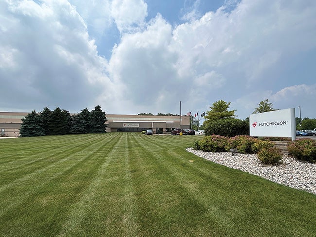

As commercial and industrial facilities face growing pressure to reduce emissions, lower costs, and build resilience into their operations, the spotlight has shifted to power. At Hutchinson Aerospace and Industry’s Ithaca, Michigan, facility (Figure 1), this shift has translated into a multi-year transformation focused on energy precision: leveraging data, digital monitoring, and system-level upgrades to cut power consumption while improving operational outcomes.
1. Hutchinson Aerospace and Industry has reduced power costs and optimized operations by adopting an energy strategy that includes leveraging data. The plant, located in Ithaca, Michigan, features digital monitoring and system-level upgrades as part of its push to decarbonize and make the facility more efficient. Courtesy: Hutchinson Aerospace and Industry

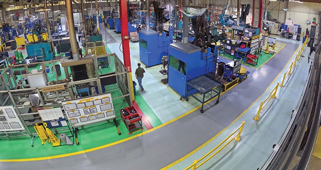

2. Hutchinson’s manufacturing facility in Michigan draws electricity from Consumers Energy’s standard fuel mix, currently about 15% renewable and 85% fossil-based. The plant’s focus has remained squarely on operational efficiency. The facility’s Scope 1 direct emissions have dropped significantly due to reduced compressed air demand, and Scope 2 emissions have declined on a per-unit basis as electrical systems have been fine-tuned to avoid waste. Courtesy: Hutchinson Aerospace and Industry
Production startups were another area of transformation. Previously, multiple systems activated simultaneously at shift change, creating demand spikes and unnecessary charges. Now, using a real-time monitoring portal provided by Consumers Energy, teams stagger activations based on actual production needs (Figure 2), smoothing load curves and reducing peak demand penalties.
