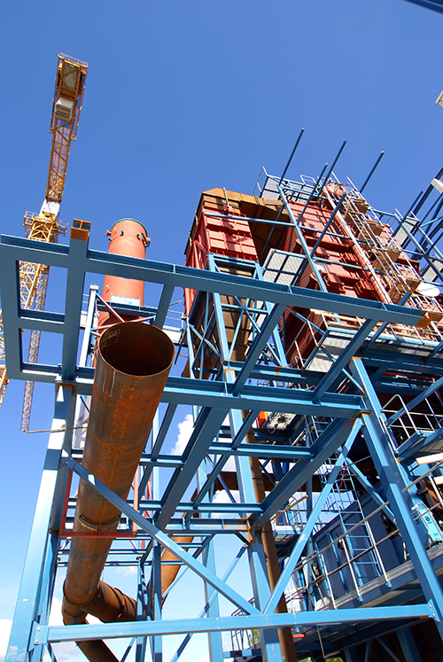

EnergyLink Fig1-cranes-and-beams Image
Developers are increasingly valuing execution confidence over initial cost. A low bid that leads to delays, overruns, or quality issues ultimately costs more. Source: Envato Elements

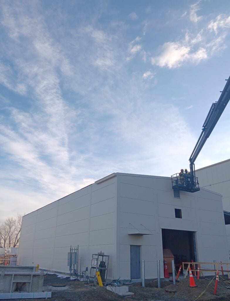

What this has meant for EPCs and OEMs is the need to find suppliers who can do more. On the two building projects last year, EnergyLink completed the design and drawings in addition to the supply and construction. Another example is an OEM of large reciprocating engines that is directing its clients to EnergyLink for start-to-finish noise control, a function it had handled before. Another OEM/power developer has executed a long-term agreement with EnergyLink for prioritized supply and delivery of selective catalytic reduction (SCR) units for their increasing fleet of peaking power plants.

Wong: The push to limit installation time is driving the adoption of modular designs for our noise and air emissions equipment. For example, EnergyLink has optimized our SCR ductwork to be shipped on standard-sized truck beds in the fewest possible pieces. Once onsite, our quick-connect designs expedite the erection process, allowing each SCR ducting system to be installed in just seven hours with an experienced field crew.
Additionally, EnergyLink is developing modular SCR units for mobile power applications. These compact, modular SCR systems can remain on a truck and be easily relocated from site to site. We are co-developing this product with several mobile power companies.
Acoustic products in our lineup are also modular, including enclosures, combustion inlet and discharge systems, ridge vents, panelized wall systems, and more. By utilizing modularization, we help reduce transportation and installation costs for EPC contractors and owners alike.
