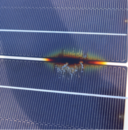

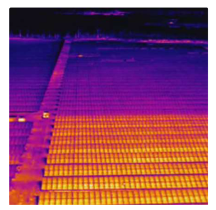

Drone-based thermography has gained popularity as a non-contact, aerial method for assessing damage. This infrared (IR) technique uses cameras mounted on drones to detect anomalies in temperature, such as hotspots, defective strings, or inverter failure. Advanced software, sometimes powered by artificial intelligence (AI), then interprets these images to identify potential problem areas across the site.
However, while drone-based thermography (Figure 1) can be helpful, it should not be seen as a standalone diagnostic tool. The method is highly weather-dependent; wind, cloud cover, precipitation, and frost can all distort results. Camera angles and drone altitude also affect image accuracy, and without pre-damage thermal scans for comparison, it’s difficult to assess degradation conclusively. Some damage types, such as microcracks in module glass, don’t show up in IR scans at all.
1. Infrared drone imagery can detect hotspots, diode issues, and string anomalies—but weather and angle sensitivity limit reliability. Source: Engineering Design & Testing Corp.
Many drone-based thermography scans are analyzed by AI algorithms to identify defects. These algorithms are often not trained to spot unique and abnormal failures. Lightning strikes and hailstorms are two common weather events that create unique damage patterns that AI-based thermography detection struggles to identify.
Moreover, thermographic data often lacks the resolution needed to differentiate between a functional defect and surface dirt or shading issues. Misinterpreting these anomalies can lead to unnecessary repairs or missed problem areas. In short: drone imagery is a valuable supplement, but not a substitute, for ground-based diagnostics and methodical testing protocols.

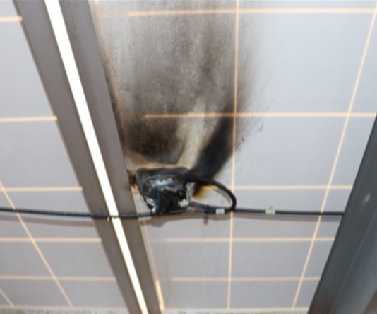

Visual Inspection: This remains one of the most effective tools, particularly when integrated into a structured walk-through with trained personnel capturing labeled images and damage tallies per combiner box or block. Damage can be noted directly on as-built drawings to support streamlined remediation. Photos (Figure 2) should include metadata such as timestamp and geolocation to verify findings and support insurance claims.
2. Having photos of damage, including metadata, can be valuable to verify findings and support insurance claims. Source: Engineering Design & Testing Corp.

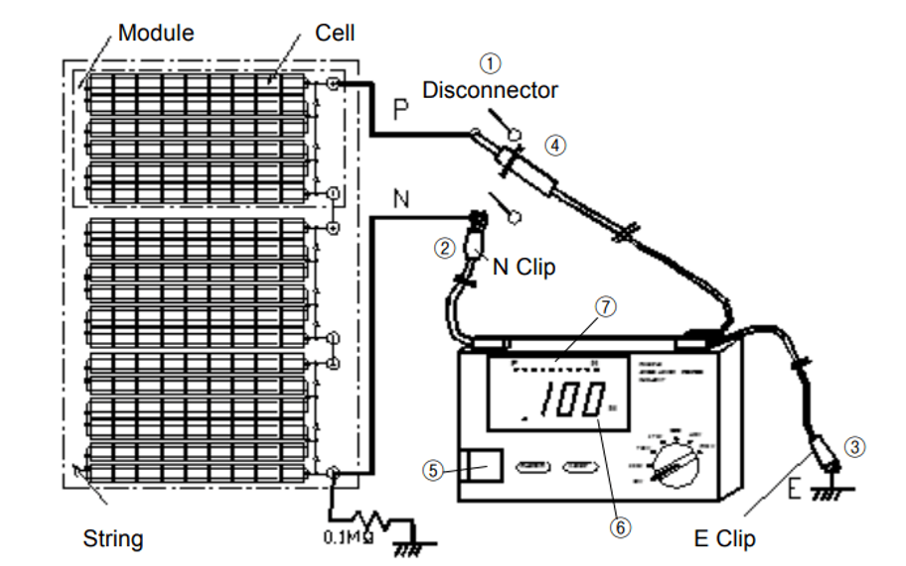

Insulation Resistance (IR) Testing: This test (Figure 3) checks the integrity of wiring insulation and detects ground faults. It’s not weather dependent, is inexpensive to perform (equipment under $1,000), and applicable at multiple points: modules, strings, or combiners. It is particularly effective for identifying latent faults in string wiring that could pose fire risks or safety hazards if left unresolved.
3. Insulation Resistance, or IR, testing checks the integrity of wiring insulation and detects ground faults. Source: Engineering Design & Testing Corp.

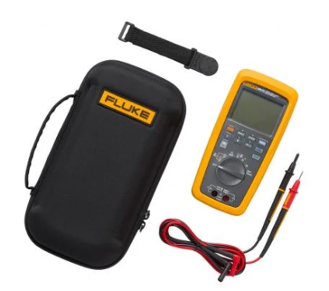

Voltage Open Circuit (Voc) Testing: A solar module’s open-circuit voltage is not as dependent on the irradiance levels as the current. Therefore, Voc testing (Figure 4) helps confirm whether modules or strings are producing expected voltage under open-circuit conditions. It’s a quick “go/no-go” check that can be done during daylight, with minimal weather influence. It is often used to validate visual damage observations or highlight discrepancies in string-level performance.
4. Voc testing helps confirm whether modules or strings are producing expected voltage under open-circuit conditions. Source: Engineering Design & Testing Corp.

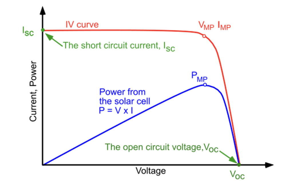

IV Curve Tracing: This test (Figure 6) plots current versus voltage at various loads, offering a detailed view of module performance. It’s effective during repair commissioning but requires sunlight and can be cost-prohibitive at small scale, as equipment costs range from $5,000 to $20,000 depending on system voltage.
6. IV Curve Tracing plots current versus voltage at various loads, and offers a detailed view of module performance. Source: Engineering Design & Testing Corp.
Nonetheless, for high-priority areas, such as central arrays or locations with repeated failures, this test can prevent unnecessary replacements and verify long-term reliability.

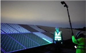

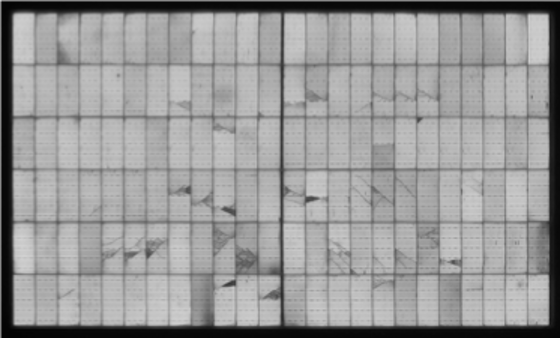

Electroluminescence (EL) and ultraviolet fluorescence (UVF) scanning: Both EL and UVF (Figure 7) can detect microcracks and degradation at the cell level. However, they are expensive, labor-intensive, and not always suitable for large-scale application. EL scanning must be performed at night or indoors. UVF only works with certain module types and is also light-sensitive.
Both electroluminescence (EL) and ultraviolet fluorescence (UVF) scanning can detect microcracks and degradation at the cell level. However, they are expensive, labor-intensive, and not always suitable for large-scale application. EL scanning must be performed at night or indoors. UVF only works with certain module types and is also light-sensitive. Source: Engineering Design & Testing Corp.
